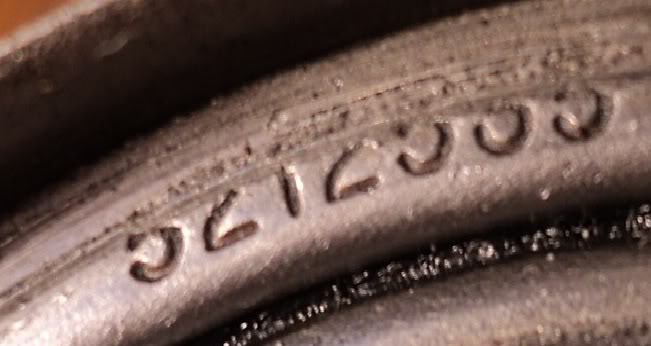

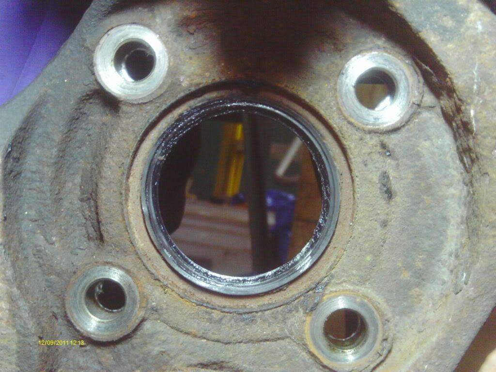

Need to replace my front hubs.
There is a metal piece at the end of the cv axle on one side. It comes off and appears to be a race of some sort. I don't know the name of it and can't find it anywhere in the autoparts catalogs. I need 1.
There is a seal that is pressed into the hubs. Again, I cannot find anyone that has it. I have not tried the dealer yet, but I'd like to know what the heck the parts are/part #'s to make sure I'm asking for the right parts. Unfortunately, I can only see 4 of the 7 numbers on the seal... 5212???
I have pictures if anyone would like me to see what I'm talking about.
Any help is much appreciated. Thank you!

Take exact pictures of what parts your talking about.

Yes. It looks like the dust shield. I have removed the pressed in seals from the hubs. I will try to upload the pics. Need to resize them.
I really prefer to have the dust shield on. The seals that are pressed into each hub is kind of a necessity - to keep water grime from getting in between the spline and easily into the bearing.

The site will not allow me to upload pictures. Not sure why.

www.photobucket.com is a good site to upload to, you don't have to resize it for PB.

Here they are:
Thanks for your intrest in helping!

this is probly what your looking for. any parts house should have it or be able to get it within 1 day. my '96 didnt have them seals. different front axle design maybe or rather different steering knuckles i guess.
http://www.oreillyauto.com/site/c/se...990&vi=1087433

Originally Posted by 90dakota4wd
"5212533" are the numbers on that seal
