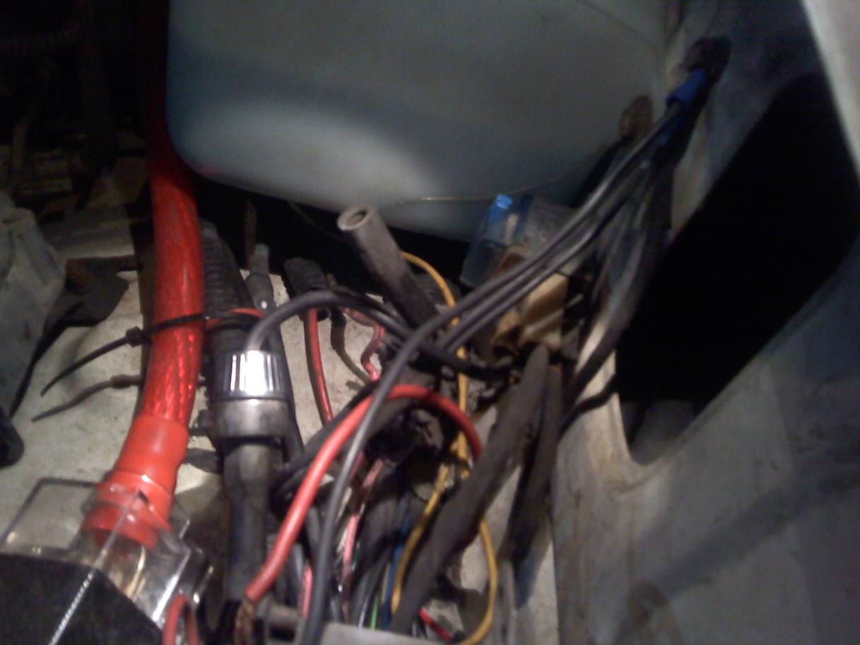

happy new years all. well I soldered in a new wire in place of those old splices, still nothing. But, I found a wire dead end, that has electricity and doesn't seem to be connected to anything. maybe this is the problem? here's the pic, its the black connection tube in the middle of the picture. I couldn't seem to locate the other end. it was pretty dark outside, and that could be the problem, but does anyone know what this wire is or where it is supposed to connect?

Their could be a number of things causing your problem. I have a 92 Dakota the's teaching me alot about the ignition system. If you deffinatly have no spark , that is controlled by the computer, but the computer needs input from diffrent things to fire that coil. Things I would check are (ASR) auto shutdown relay, if that dosn't get a signal from the tack that says the motor is running , it shuts down the fuel pump,and the ignition system. Then I would check the crank case position sensor, if the computer dosn't get a signal from that no spark, kicks out the ASR . Next thing you could check is the distributer pick up sensor, again no signal no spark. Hope this helps.
