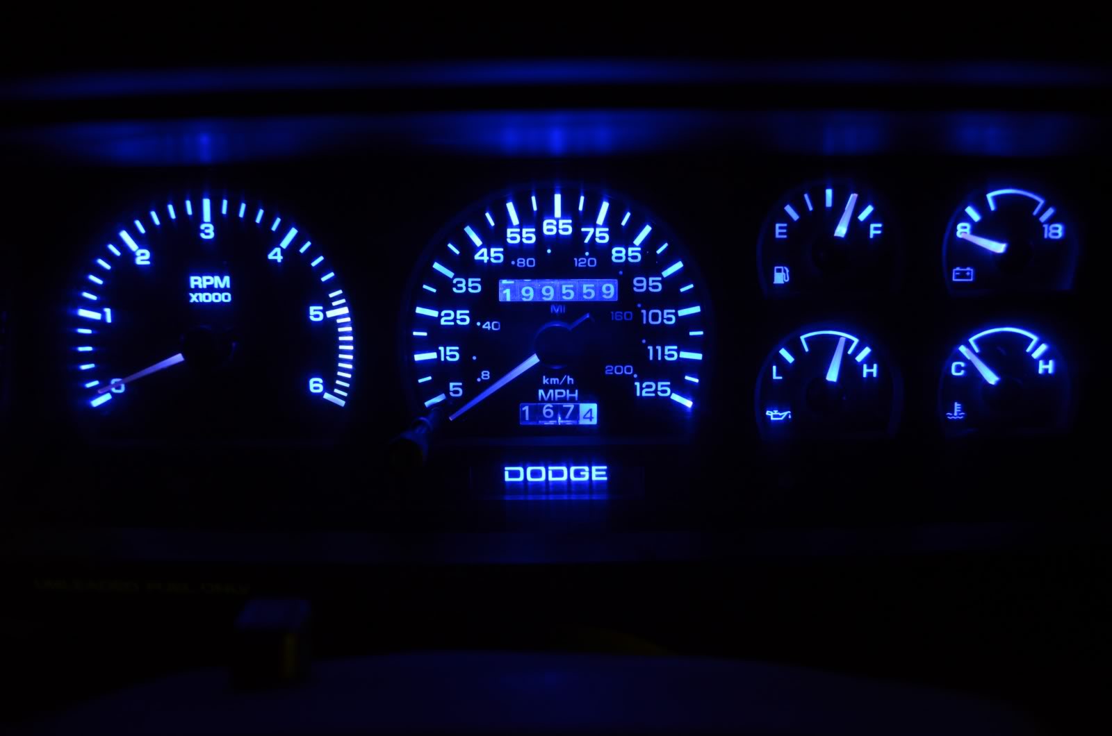

The most recent mod (actually done last night) was swapping the main Dash lights with some premade 168/194 size blue LEDs from ebay:
before:
and after:

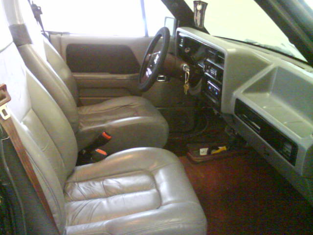

Just doing a repaint will not bring this truck all the way back. the chairs are falling apart and the floor needs replaced. i was thinking about swapping in some chairs from a newer dodge, like this:

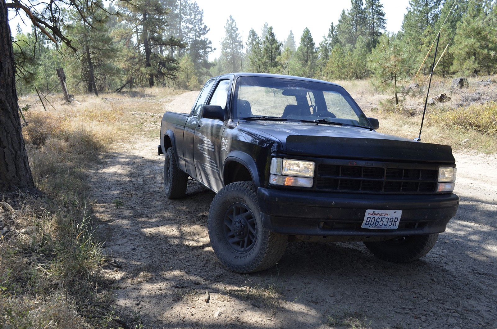

As you can see from the picture, i did a 2in key lift for the front end and put some 31s on there that i got for free from a co-worker who just had them laying around. i still need to find some tires for winter though.

Nice looking truck.
I'm hoping to be driving on a similar road in WA next year.
Looks like the roads I drove on west of Wenatchee, WA.
Good luck on the project.
These older trucks may suck fuel but they don't suck. hehe
