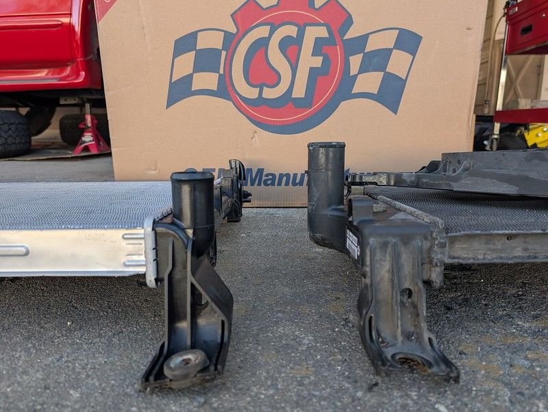

The radiator shipped from Portland and came to me overnight. That was a plus. Side-by-side the CSF 3516 is beefier looking unit. So far it appears everything is a direct fit. I like how they are using spring style back-up clips versus the square back-up nuts that want to spin in the plastic radiator housing. Took me about an hour to remove one of the A/C condenser bolts and one of them broke off. Currently I'm waiting on new hoses, thermostat and electric fan before I can finish the job.
