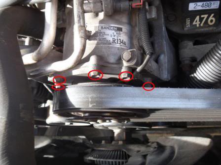

Ok I finally got around to playing with this again today. I figured out the problem was due to the outer clutch plate broke loose from the inner clutch plate so it was causing all sorts of issues. Based on the Service Manual it requires special tools and pullers to rebuild the clutch, and the kit costs $257 so I am not going that route. I still do not want to remove the compressor if at all possible but I am curious as to if I can remove the front plate of the compressor without evacuating the refrigerant. It seems as though it should be possible by removing the bolts circled here...
I really doubt the manufacturers would have relied on a giant seal between those two pieces to hold back the refrigerant. So if I can remove that section of the compressor, then I could buy a used compressor for like $60 unbolt the used front section and bolt it onto the compressor that is on my truck.
What do you guys think?

Nope it won't work. There is no way around it, just take it to a shop to get it evacuated. Then replace the compressor, then recharge it. Most places will evacuate it for free if you come back to recharge it. Most places will give you a slight discount since you should mostly use your old refrigerant that they took versus getting all new.
