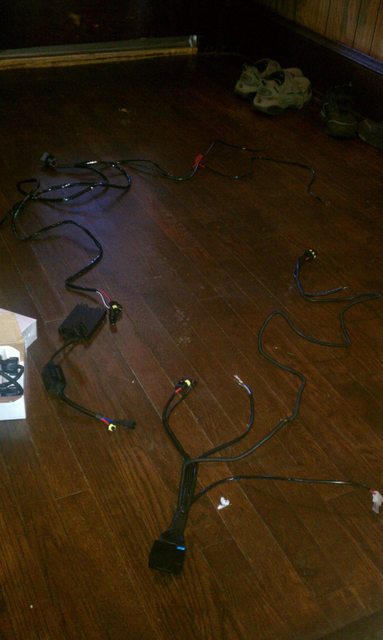

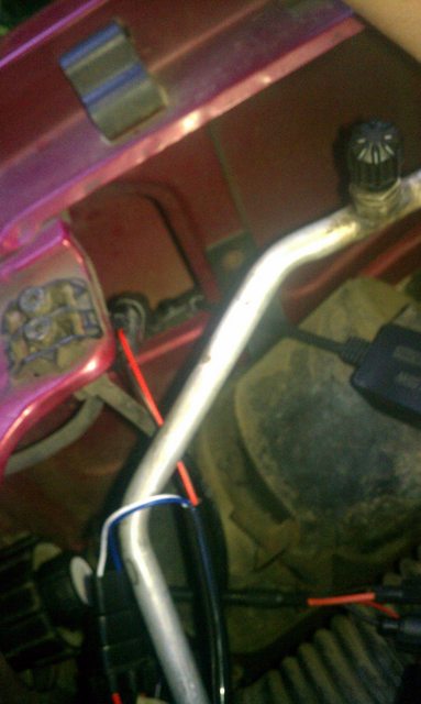

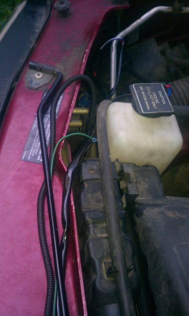

HID Kit installed. Low and high beams are working.
I didn't mount anything because I'm lazy.
I might move the wires that are going to the other side, going to see if they get really hot where they are right now.

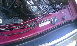

Left HID thing is inside the firewall

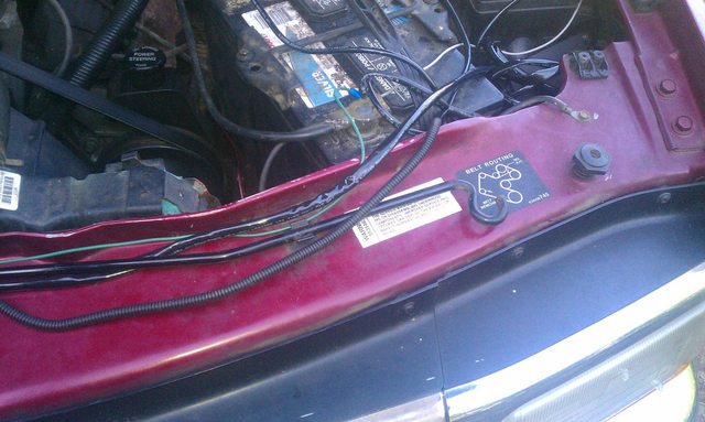

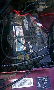

That relay is for my reverse lights, the HID relay is in the 2 pictures below.

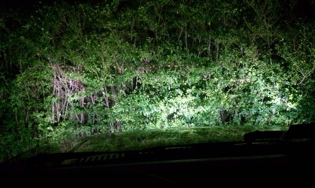

A LOT better than the original 9004 bulbs. I replaced the regular bulbs before with the silver bright light at autozone and it still only let me see about 5 foot on the road.
These were taken about 10:15 PM, pitch black out.
High Beam / Sucky Phone Camera to the max

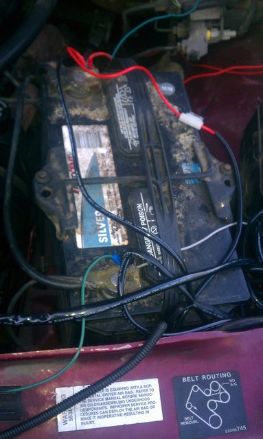

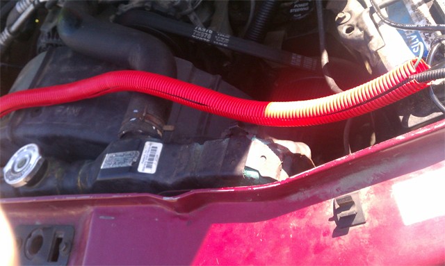

Can this wire sleeve melt from the radiator hose if I leave it here?
