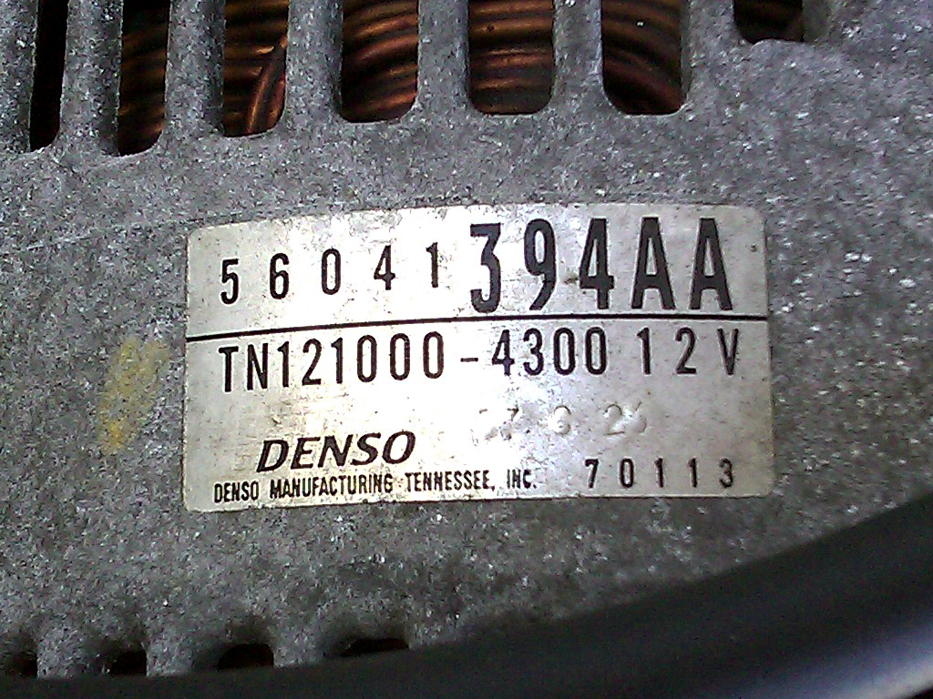

We have already passed this idea onto strictly Chrysler alternators (56041-394AA). Yes and no, if I am listening to my stereo with the engine off a 200A will recover a deep cell battery much faster while continuing to draw the same load once the engine is started.

Here is my alternator in the Grand Cherokee 5.9 Limited sitting in my driveway:
This cross references to a 150A:
Notice all the same wires; two field wires, a ground and battery +
My current 65-75A:
