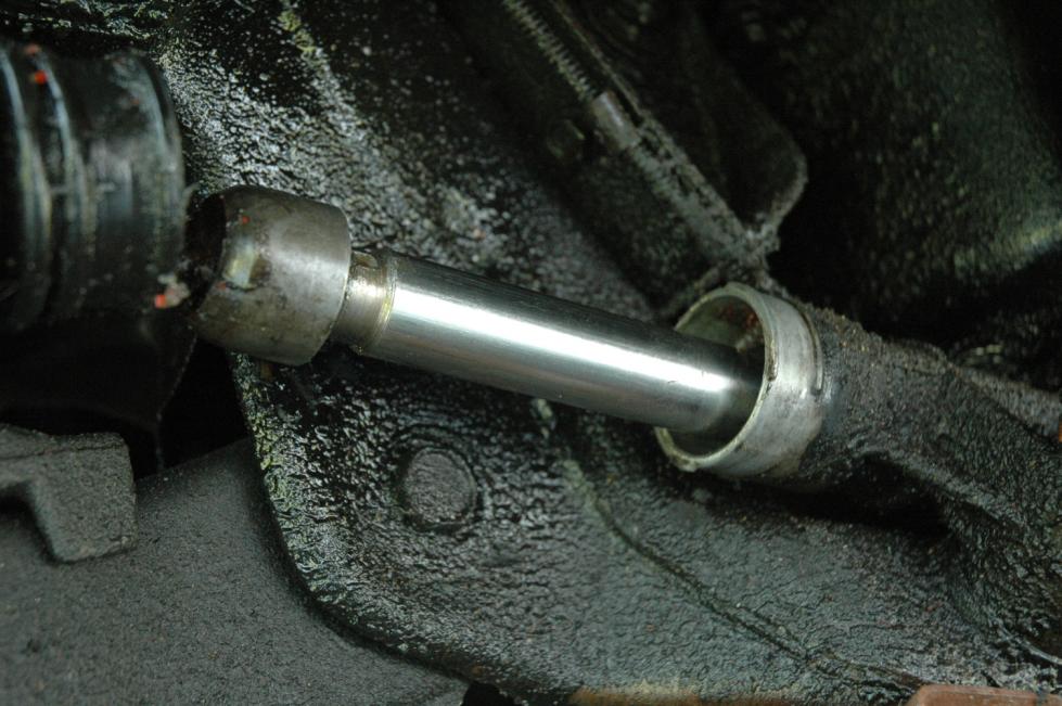

Ok, I'm the guy with the original 88 Dakota, with the steering clunk.
Junk yards around here do not have a replacement manual rack and pinion, so plan 2:
Today I took the boot off and the inter tie rod looks pretty good. The knock is coming from the shaft on the out end of the rack which seems to have had a bushing to guide it through the rack and pinon housing. All that's left is some crumbling red plastic pieces. I'm assuming that the end of the rack and pinion housing had a bushing for the shaft and acted as a grease seal. made of nylon or hard plastic. I believe this rack was filled with grease, rather than oil, so the seal on the out put shaft is a little forgiving, doesn't have to be high pressure...
I'm a professional machinist and can turn a piece of nylon or derlin to make a bushing, as it seems there is not a aftermarket replacement part. It looks like it was a press fit into the housing, and I could do a light press fit as it only seems to be about 1/2in thick.
At first thought, I don't see how this would hurt anything. My bushing will be better than the original, will keep the grease in the rack, and prevent the side to side movement.
Any thoughts on making my own bushing regarding safety? I can't seem to see how making my own replacement part is a bad thing....Leaving it alone and I think the rack output shaft hitting the housing is gonna be bad...
