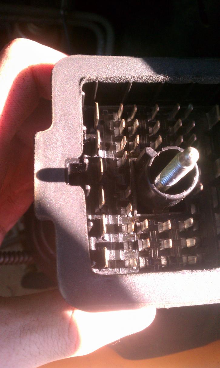

Old May 24, 2012 | 07:04 PM
dakota00's Avatar
dakota00
Joined: Sep 2006
Posts: 29
There is a bolt that runs through that connector that you gotta take out before you can unplug it. If your truck keeps blowing fuses there is a possibility that there is a bad corroded or wet terminal(s) inside the connection at the firewall. When I pulled mine I had a terminal just fall apart from corrosion.
Old May 24, 2012 | 07:19 PM
zachtpike's Avatar
zachtpike
Joined: May 2012
Posts: 6
If this is what you're talking about it seems like everything is fine.
