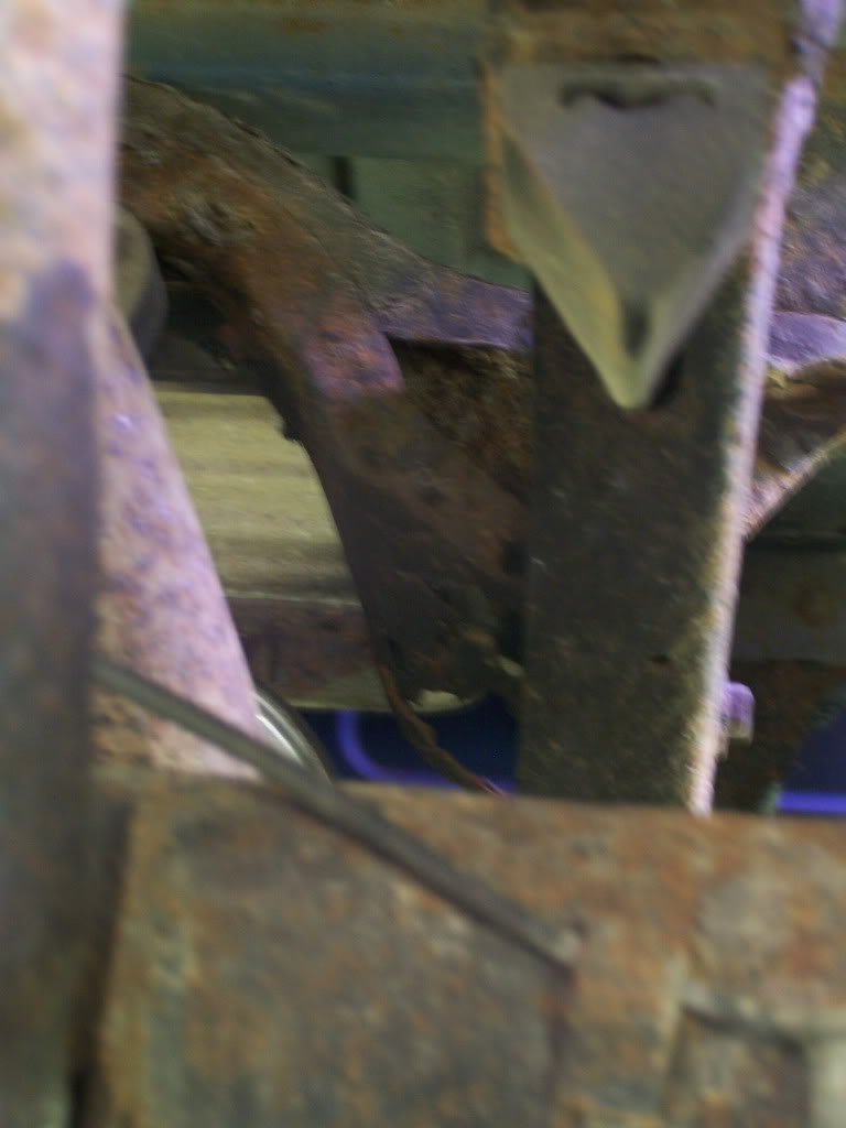

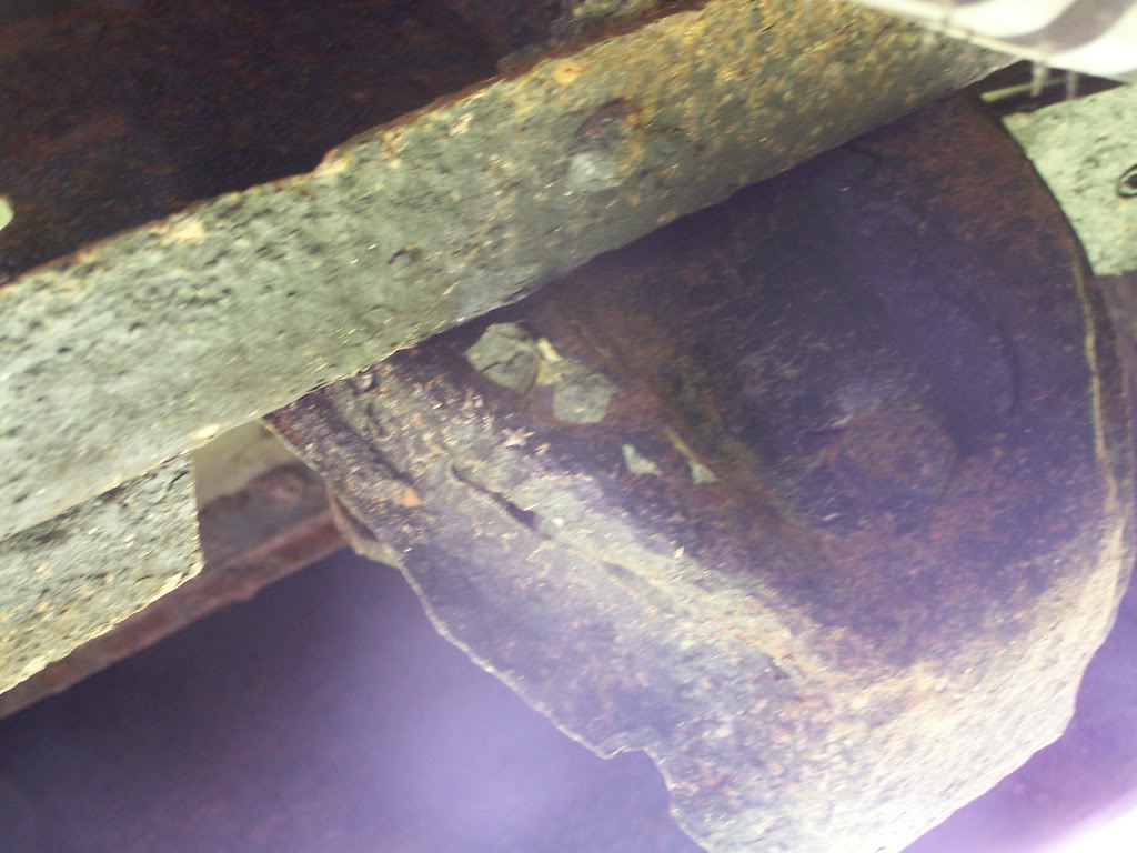

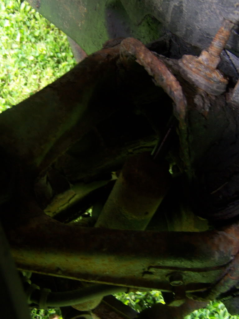

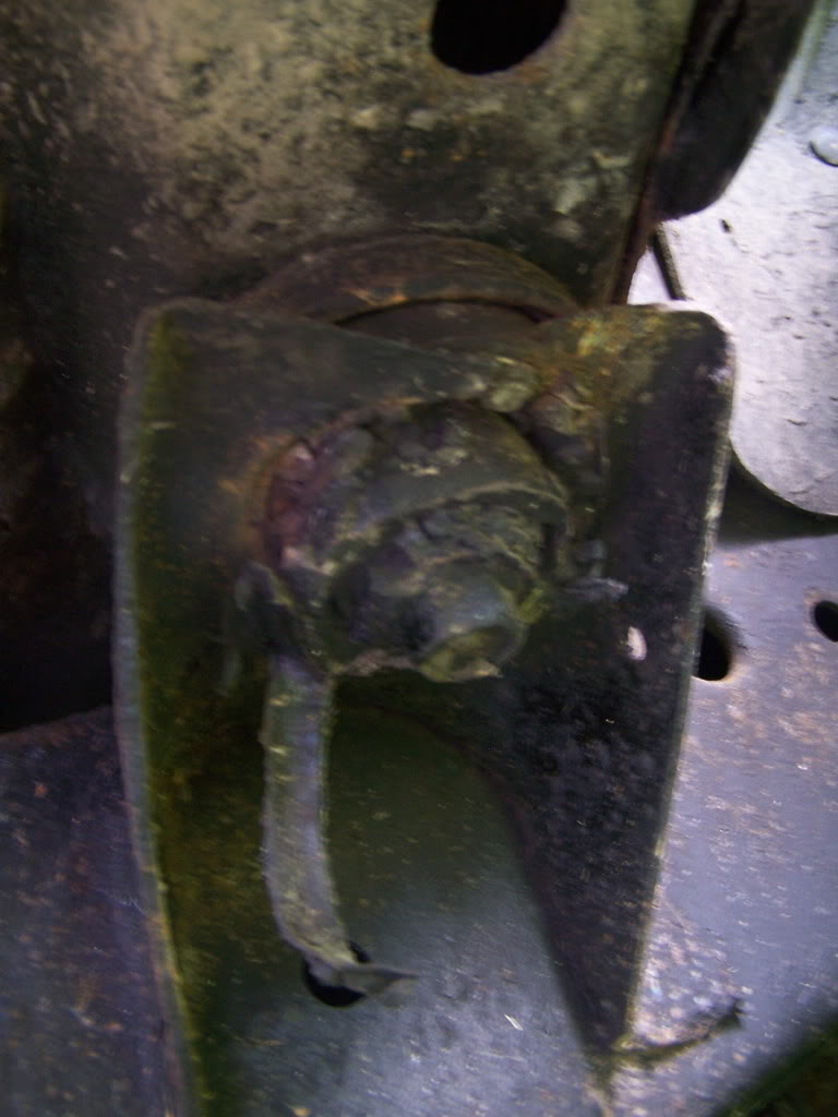

here are some pics i took close up of some of the bad areas

That's pretty much what mine was looking like when I first got it. Take a screwdriver and poke around the front upper shock mount brackets and see how bad the rust is. If the outer stuff falls off and you don't have holes, you should be good for normal on-road use.
Mine were almost exactly like yours, pretty rough looking. I chipped off the loose rust, sprayed rust inhibitor on them, then coated them thick with black rustoleum. I'm not sure how long they'll last with off-road punishment, but I'm in it for the long haul. When they bust off that just means I can justify a solid axle swap. If you're not planning on tackling rocks, you should be alright.
But again, it's all a matter of how much you're comfortable with spending on it vs how long you're willing to tolerate that condition.

well i took it for a drive today down to the next town to pick up some lumber. Im going to put some new shock on it bounched the whole way down the road. ins. is good till feb 13 so i think im just going pull the bed off replace shocks and paint the frame and see if theres anything else that needs done just enough to pass inspection next year. I haul about a half ton at most the quad gear and 2 people. I dont know how much stress that puts on the frame. As far as the clutch goes one min it works great the next it acts funny so I dont know. Is there anything from the pics that I should keep my eye on more then others that i dont see...... maybe put that money that ill save towards a better truck, jeep or suv

most of the rust under this thing its the back half thats the worst. Some one had tried to get it up and running before I got it. New brakes and brake line someone had tried to put body filler in it (looks like a toddler could have done a better job) but they tried new spare tire an someone had sealed up the sun roof with silicone to stop leaking. but the sway bar it the front is toast i can sway it by hand
