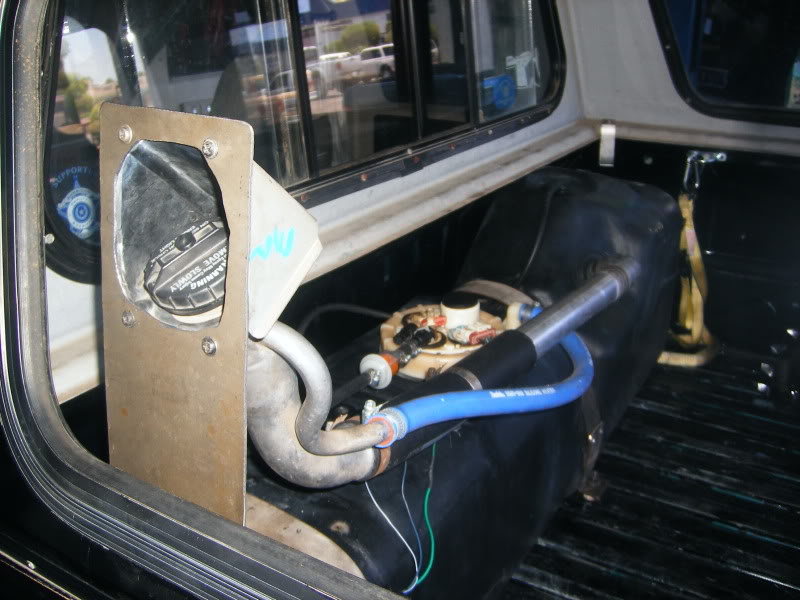

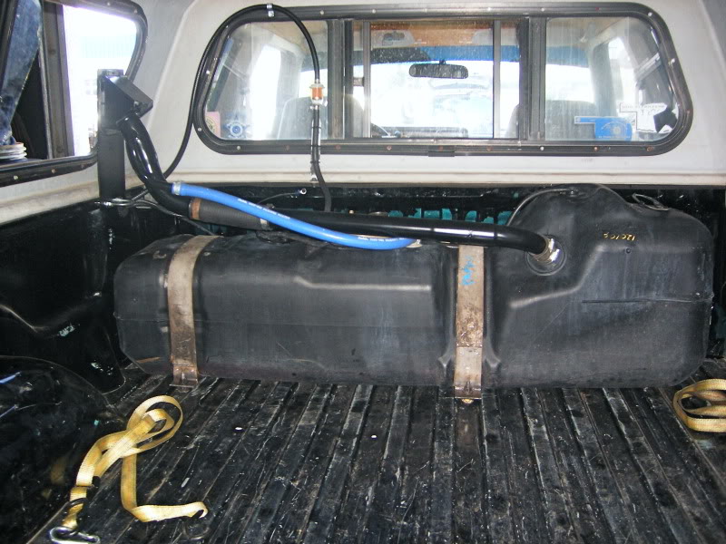

I didn't like the range of my 22 gallon gas tank. I had a spare '98 Caravan gas tank and fuel pump. I was going to use that but it's only 20 gallons, flat and wide. So instead I got a 26 gallon one out of a '99 Dodge Ram that's taller and takes up less bed space. I really wanted a 35 gallon out of a Ram but that was way too long and wouldn't work.

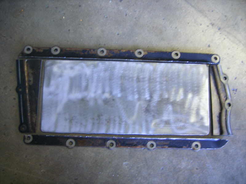

The metal I used for the fuel filler neck support. Look familiar?

This is a transfer tank only. It pumps out of the auxiliary tank into the main tank. I tapped into the factory fuel filler neck vent hose. I also spliced the vent from the rollover valve into the factory line so the vapors get collected into the charcoal canister instead of the bed of the truck. I used brass for durability. I don't trust plastic.

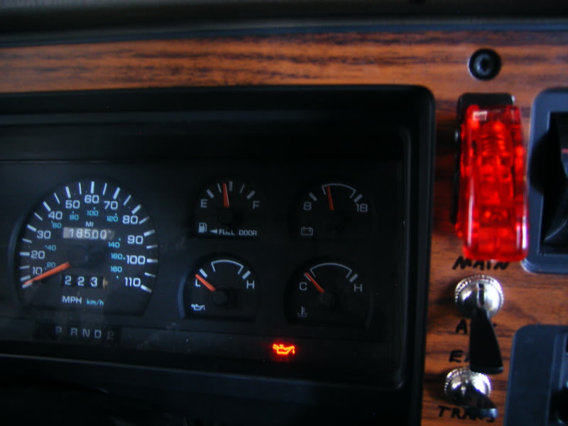

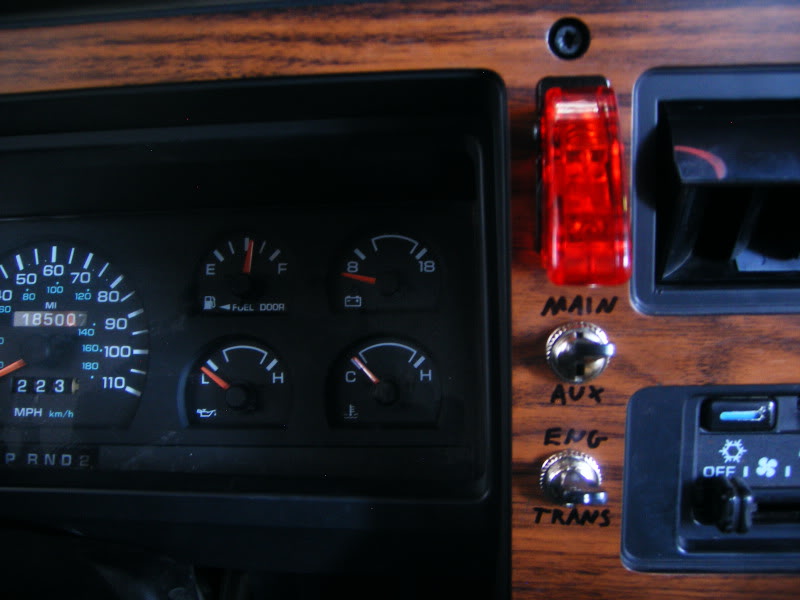

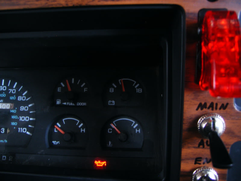

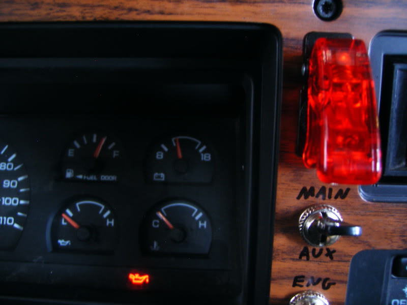

I installed a toggle switch to switch between the fuel level in the auxiliary tank and the main tank. I also installed a clear fuel filter to watch fuel flow so I'll know the tank is truly empty.

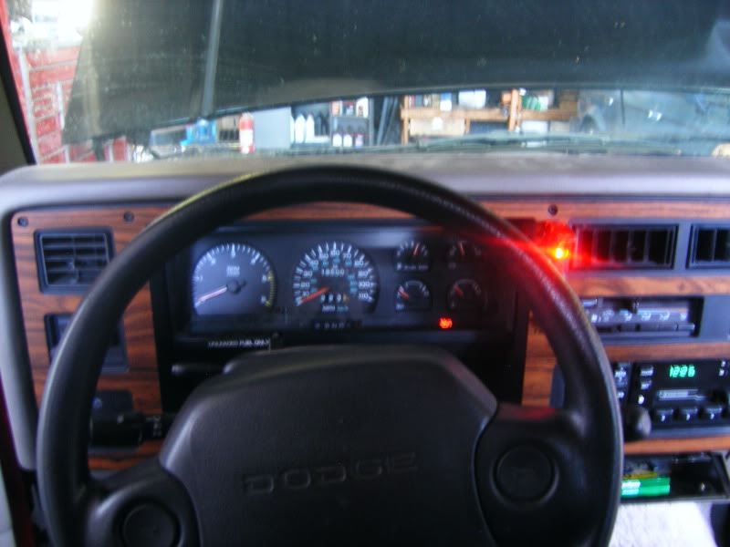

I had an normal lighted toggle switch to turn the fuel pump on. Well on my last trip I accidentally hit it. So I changed to an F-15 missile launcher type switch.
I’ll know this one is on.

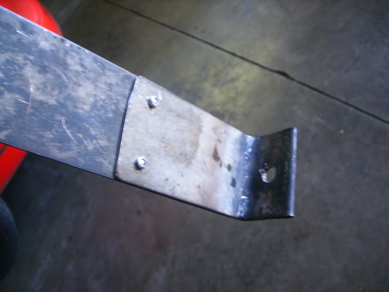

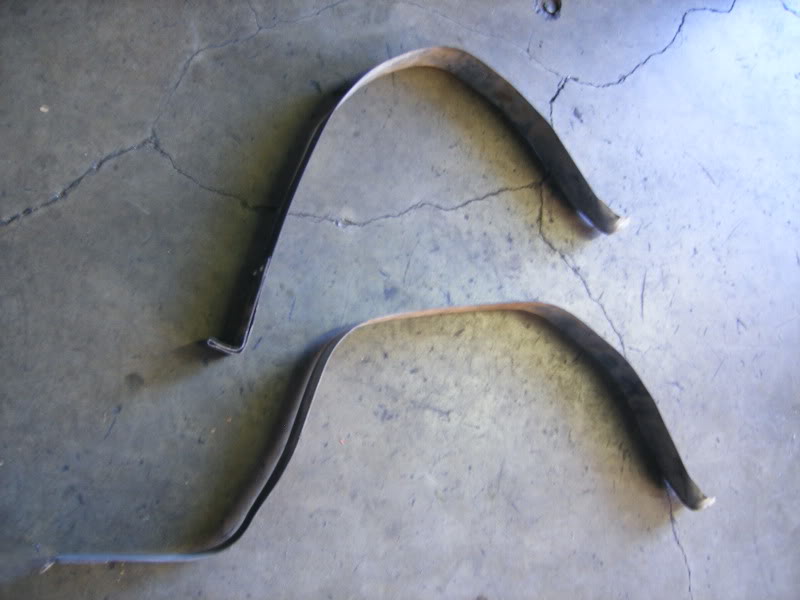

I got some fuel tank straps from a Dodge van. They were longer so I had more room to customize them.
Bottom one is original length.
I folded it over like the factory for durability.

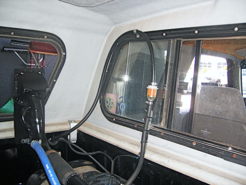

I took some more detailed pictures and also made a few modifications/improvements.
Here's the top of my auxiliary fuel tank sending unit. I used an old sending unit from my '94 Dakota with a few modifications. First the output/fuel filter was removed for the '92-'93 output/return fitting. Then the return was capped with a cap from another sender I got. My thinking is if I'm on the road and my fuel pump goes out, I can swap in the aux fuel pump to get home once I cut a hole in my bed for fuel pump access. The fuel filler vent was plugged with an extra electrical plug I had. I pulled the wires out and installed it in the rubber grommet where the fuel filler port lived. I did that because the tank came with the fuel filler vent. Then the rollover valve was replaced with a black cap that I got off of a Ram van fuel sender since the tank came with a roll over valve/vent.

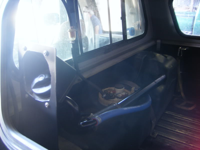

I put the clear fuel filter up higher so I can see it in the rear view mirror. I have the two tanks on a toggle switch to see the level in both but we all know that empty isn't always empty. So now I can see the air bubbles when the pump starts sucking air.

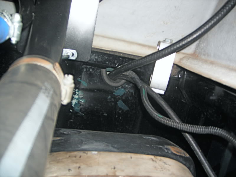

I opened up an already existing hole to run the fuel, vent, and electric.

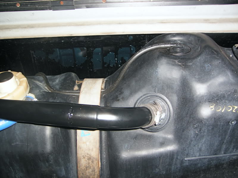

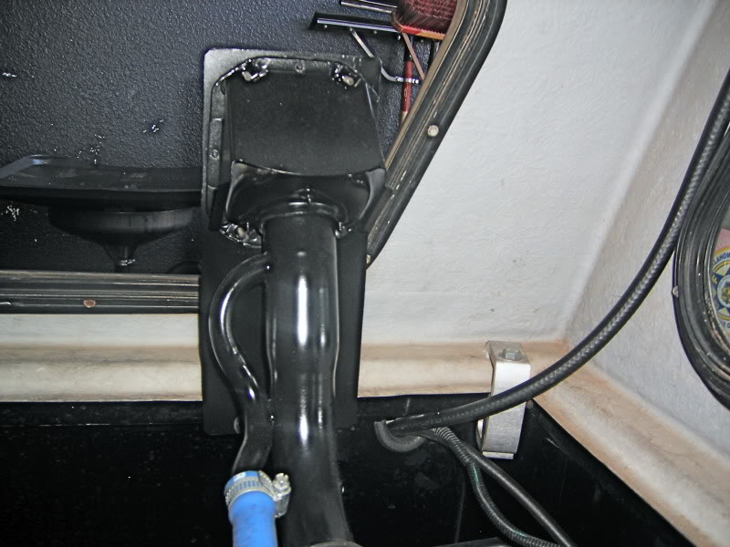

I painted the fuel filler neck and filler tube since the manufacturer never intended anyone to see them.
