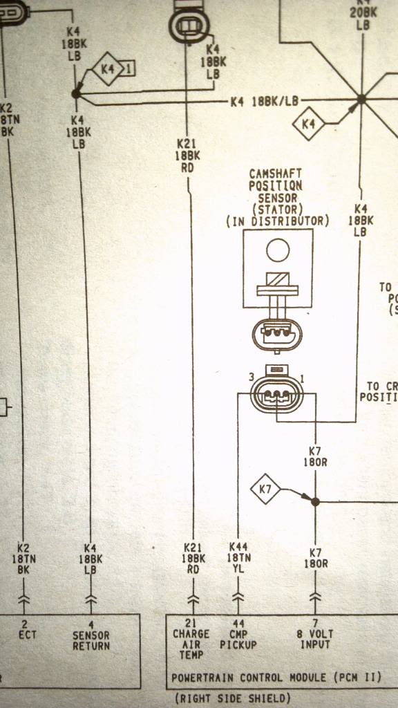

The cam sensor is a hall effect switch and can not be cleaned. Ive never tried testing the ones on the dakotas but you should be able to test it. it will show a on off on off etc with a 5volt reference. I havnt checked the schematics but there should be 3 wires a power supply (5volts) a ground and a reference wire that allows the 5volt on off to the pcm. start by checking that it has the 5volt supply, if it does then find the reference wire and pin between the ref wire and ground then slowly turn the engine over and check voltage. it should go 5v,0v,5v,0v etc. If it does that then its good. Usally if it has a good ground and the 5volt supply then the sensor is bad. Ill get my schematics out and look at the wiring.

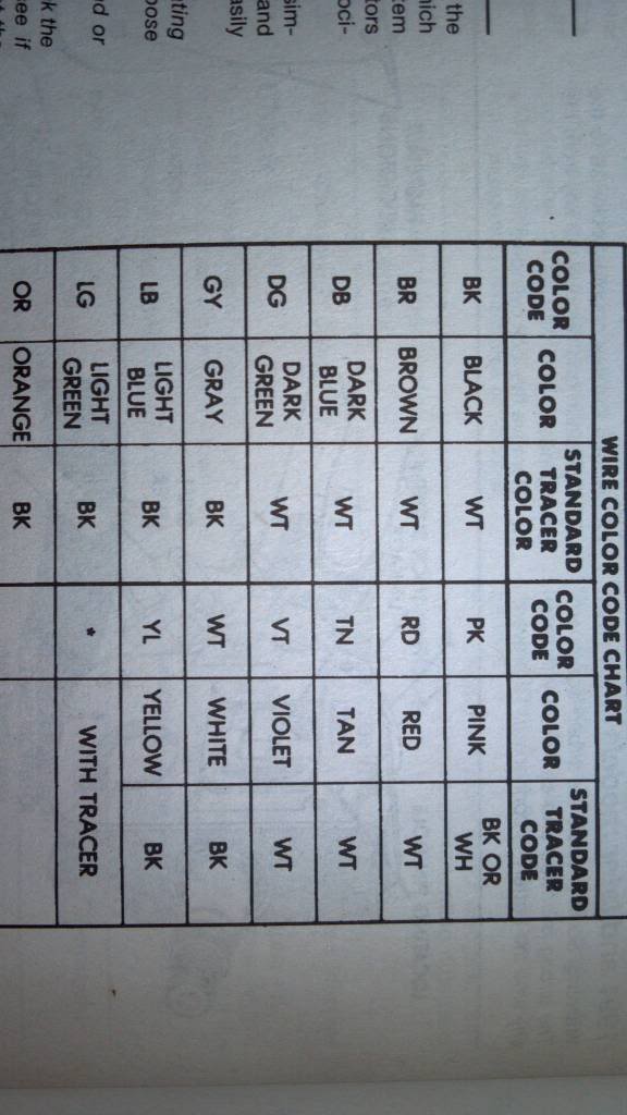

This should help you out with the cam sensor. All wiring is running back to the pcm. pin 4 is the sensor return pin 44 is the cam sensor pickup and pin 7 is the 8 volt supply to sensor.

Thanks for the help. I found that the wire from the sensor had been pinched and was broken about 6 in from the distributor. Repaired the wires and it started right up and runs like a champ. This is a very good forum and there is a lot of good information . Again thanks for all the help and I hope this can help someone else.
