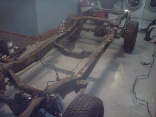

Fenders, Hood, radiator support, cowl, and some other small pieces are primed and sealed. Color and clear coats tomorrow. Once it got dark and I couldn't paint anymore, I continued stripping the frame.
