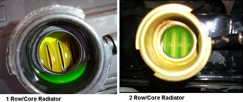

Ok here's what I found so far. As far as a radiator with a mulit-core, all metal construction I'm only seeing the CSF 2289. Selling for a significant $230+ online, compared to a plastic single core model for as cheap as $120 or so.
I'll will be making some trips to the local wrecking yards no doubt in search of a good radiator. What should I be looking for? How can I tell if it is mulit-core or single?

The CSF 2289 is the only one I can find around. Ebay has it listed for $219, if you don't find a 2 row at the junkyard. Just buy it, it is worth every penny.
I have a 2 row all metal radiator. I bought it locally for about the same price so I bet that is the exact one I have. The shop closed down, I always wanted to know who his local supplier was, because I can't find it locally again.
Here is a 2 row copper/brass radiator.
http://www.radiatorbarn.com/search.php?product=radiator
Here is a quick picture I threw together to show the 1 row vs 2 row radiator.
