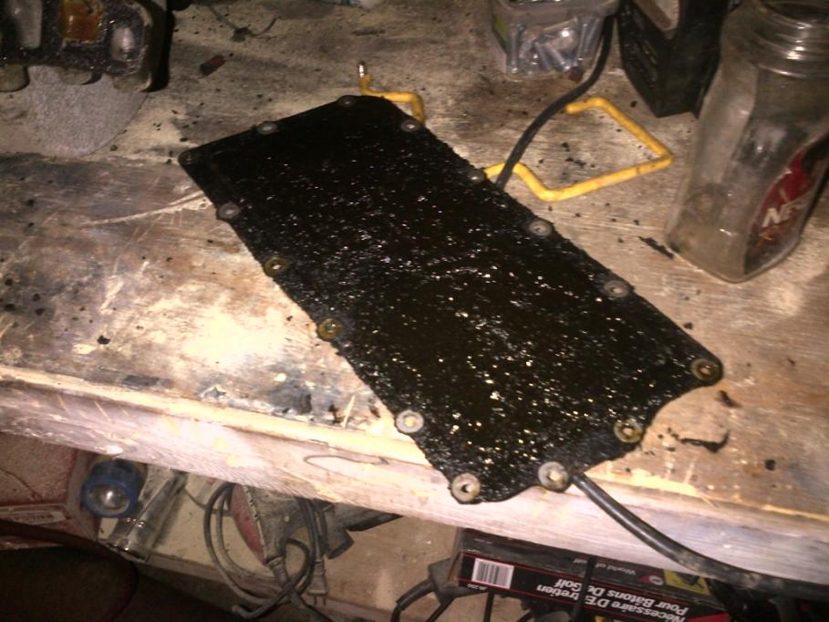

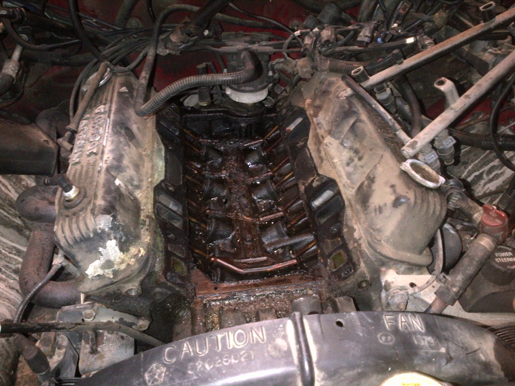

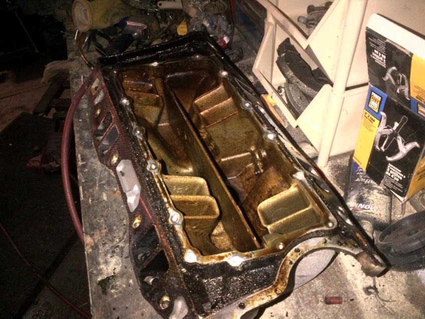

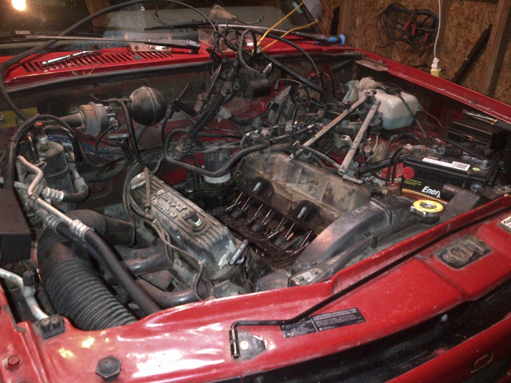

Hey guys so i bought the rebuild kit from Hughes Engines. And Here are some pictures of the intake and plate and what was inside! the rest are here.

Just like we told you 4 months ago...definitely a blown belly pan gasket. You will see a world of difference in the way it runs after you get everything back together.

Now that i have it all apart no wonder it wouldnt pass etest, and it had no *****. Thanks guys for the help. Will keep you posted on the results of putting back together and how it turns out when its done

Got the truck all cleaned up put back together, running alot better now. still have to change the CAT, and 02 sensor. im assuming the engine light is still on cause of the 02 sensor. but will keep you guys up to date when it goes in for etest!

hey guys got the truck all done. did a **** ton of work to the truck. and it passed Etest with flying colours!
