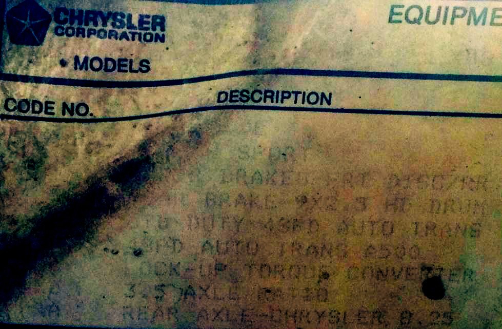

Originally Posted by MacDak
Here's my '93 3.9L: it's hard to see, but it's 8.25, 3.55 ratio. I also want some kind of locking for hunting and boat ramps.
I can now haha:
I never knew those were on the hood tag, and the transmission is on there as well! Mine got painted over.
