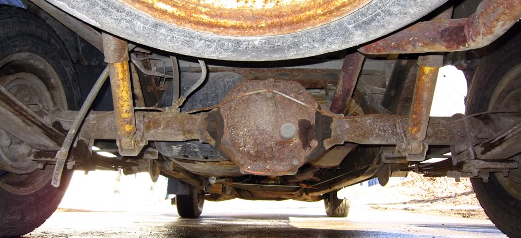

I have the 7.25" I think, which is why I wanted to switch out the whole rear end. Junkyard factory setups are much cheaper then aftermarket parts even when rebuilt.
