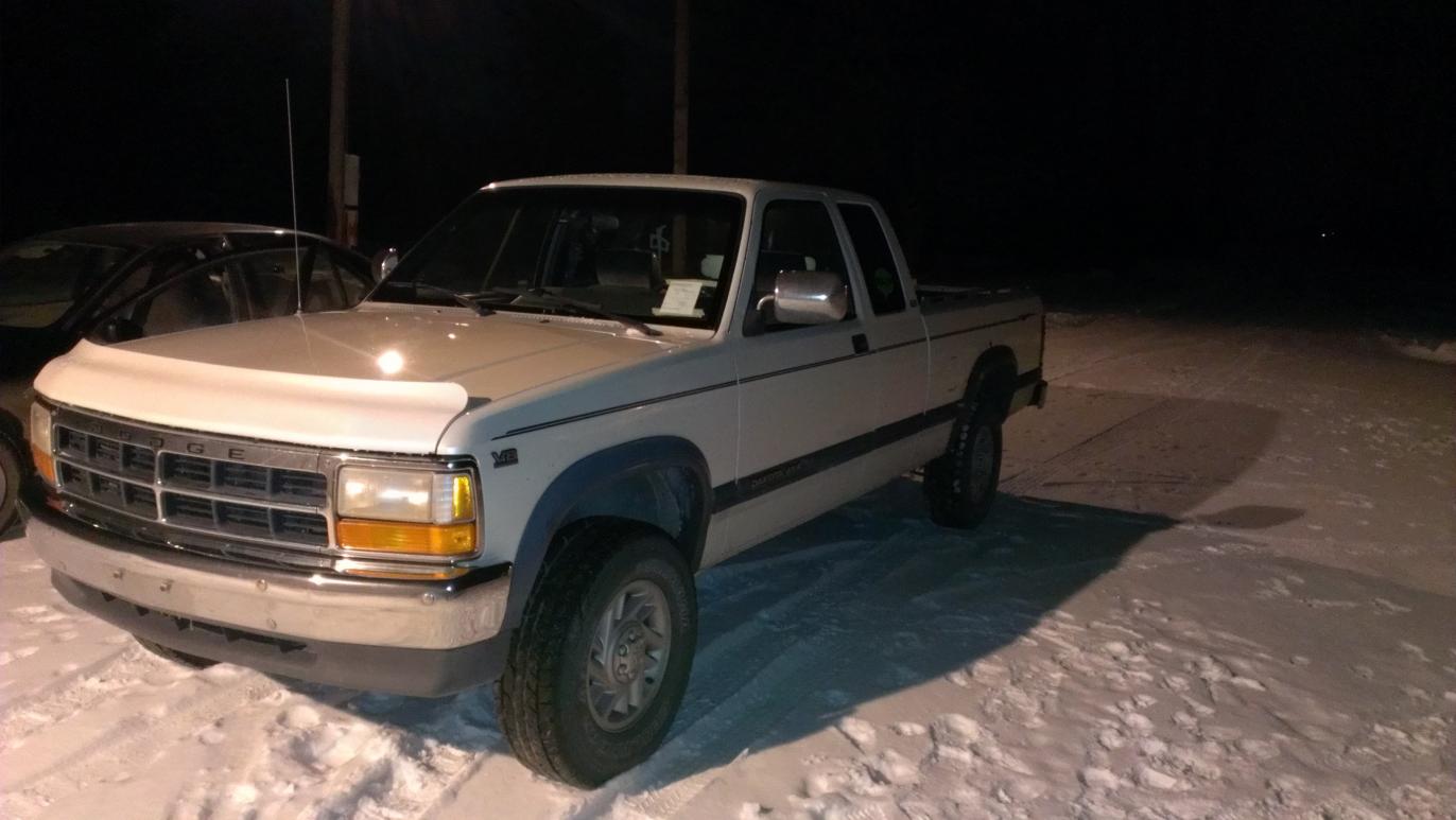

Just picked up a new to me first gen Dakota. It's a 91, with the 318, 4x4 extended cab. Truck has 380,000km's (236121 miles). Picked it up for $600 so think I got a pretty good deal. Truck runs great, 4x4 works good, tranny's good, interiors in great shape, the box has some rust, but the cab is solid.
Attached is the only picture I have of it now, I'll try and get more in daylight.

Welcome to the forums! And thats a nice lookin truck you got for only 600.
31's I think will fit, but may rub on the steering or just be real close.

Nice truck, and for only $600!
31's should fit stock, maybe rub the frame a little at full lock. My truck is stock height on 31's.
