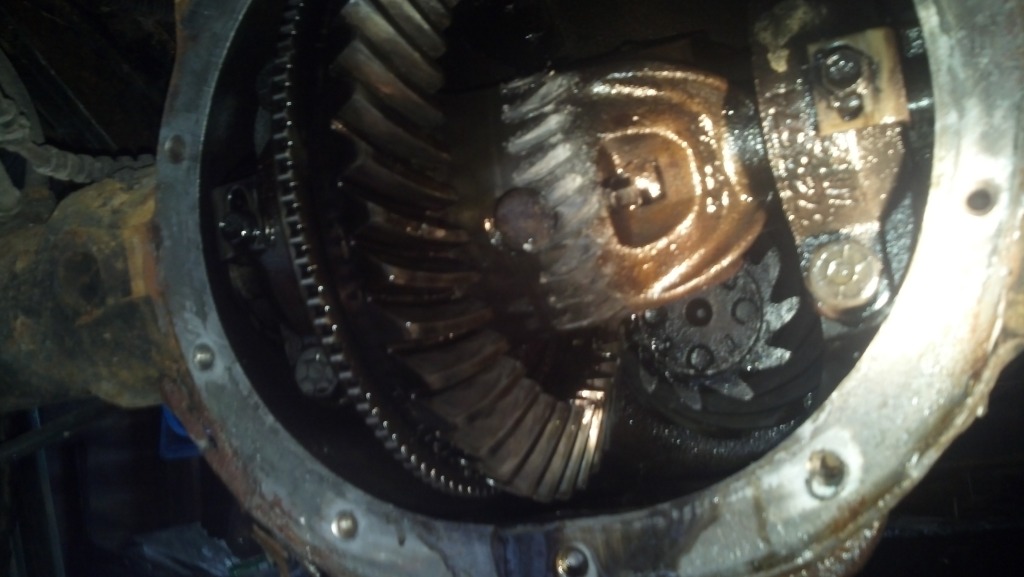

Well... if yiu cant tell the pinion gear is grinding into the differential casing

Looks like the pinion got loose. Bad bearing or pinion nut came loose or something. Your going to have to replace the carrior and ring and pinion gears and all. In this case just find a junkyard axle in good shape and swap it in.

would it be easier to swap axles or swap gears?

Unless you know how to setup the gears correctly, it is easier to get an entire axle and swap it in. Then sell your old axle to the metal recyclers and get good $$.
