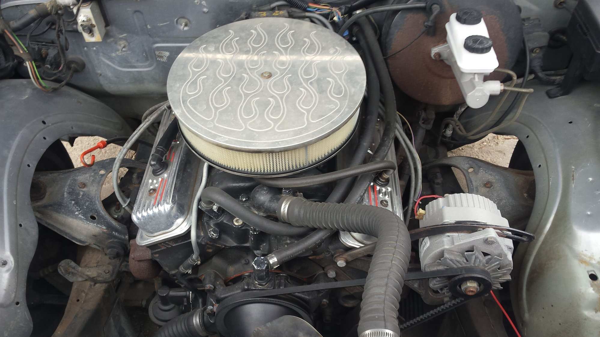

Old Apr 14, 2015 | 12:27 AM
the chodge's Avatar
the chodge
New Member
Joined: Apr 2015
Default chevy swap
Iv got a small block 350 in my 91 dodge dakota
