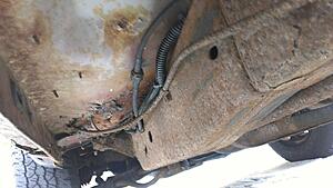

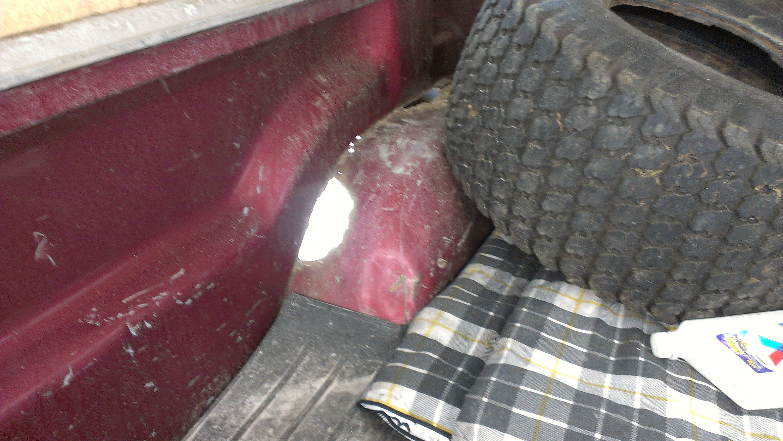

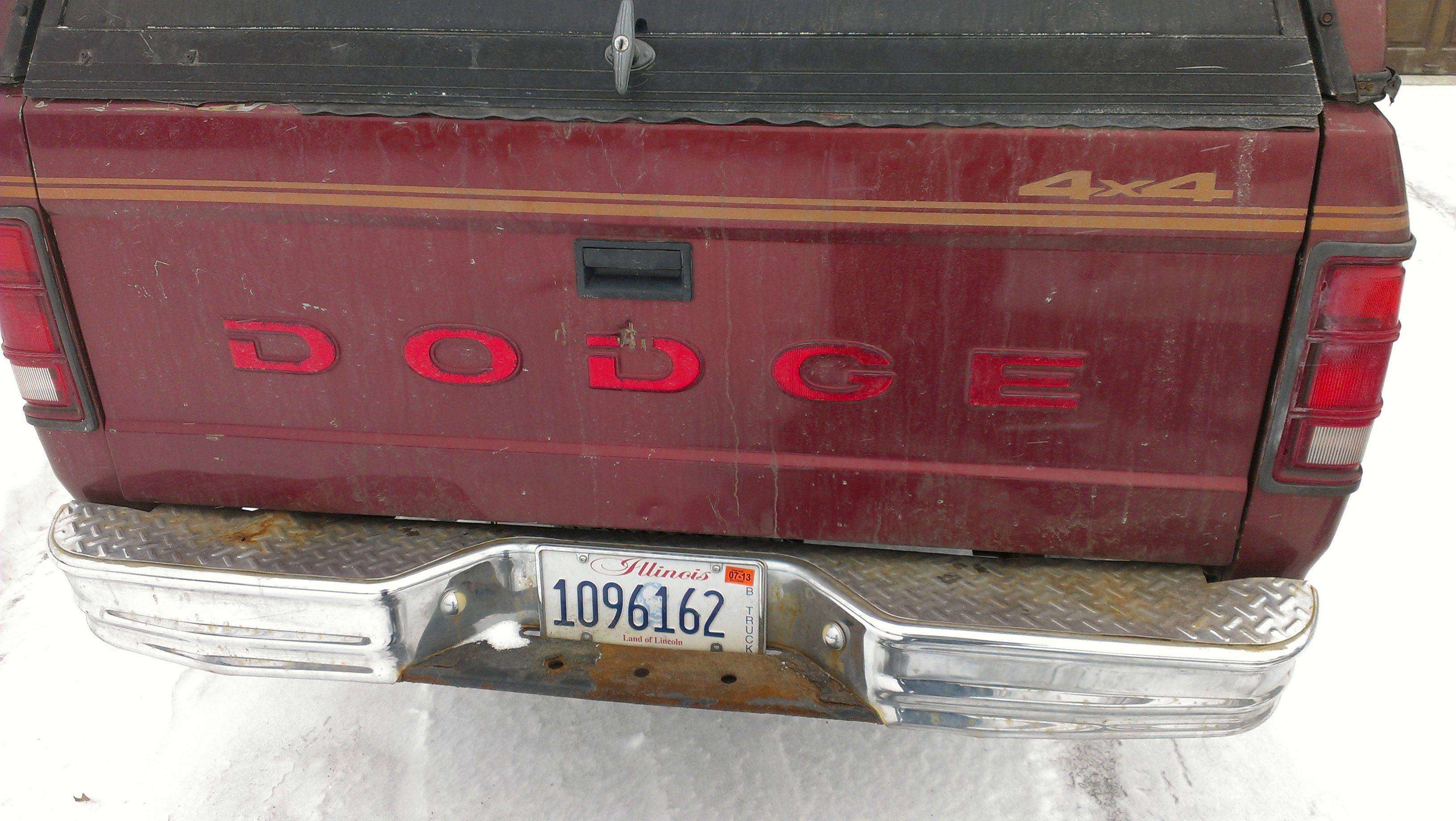

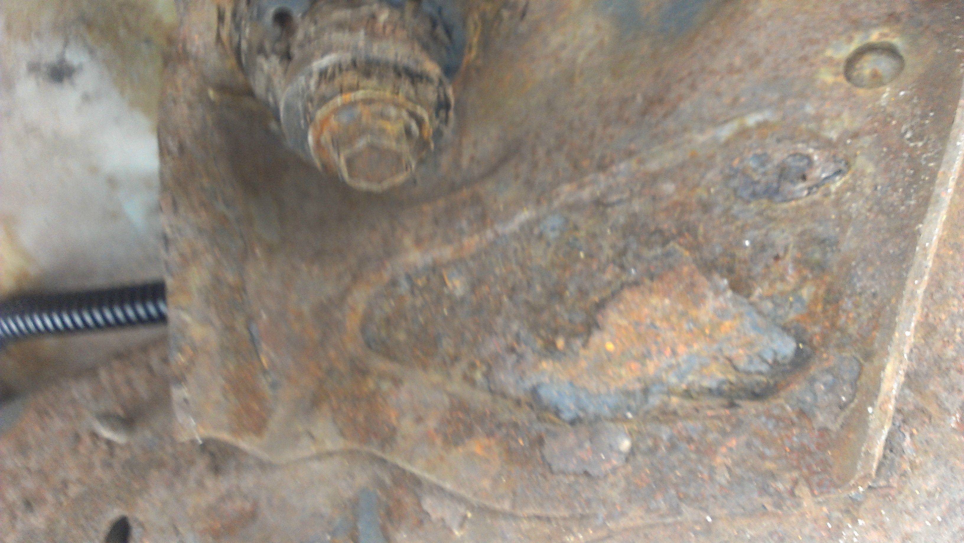

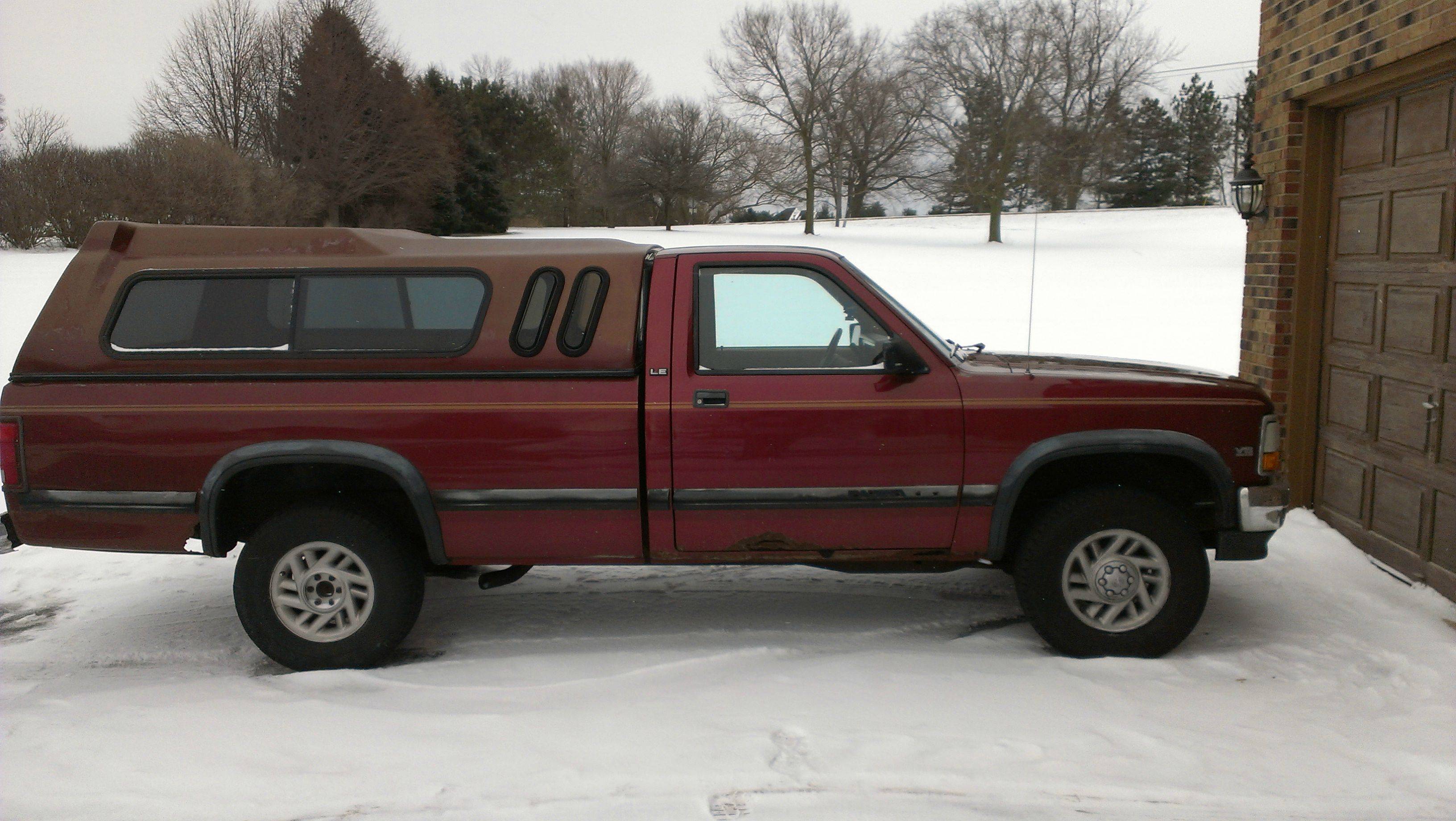

So I got some pictures here that kind of show the extent of the rust and what i want to restore.

Old Mar 1, 2013 | 04:27 PM
MacDak's Avatar
MacDak
Joined: Jan 2007
Posts: 243
From: Red Clay - Georgia
I'd try to remove the bed and maybe cab, then blast and re-paint the frame, weld where needed,etc. Looks good to me, but, hey, I've never seen a Dakota that did not look good!

From the pic the rust on the truck isn't bad at all, you could be off far worse like mine and I am rebuilding mine for the Western Canadian power cruise this summer. I would agree with everyone here and say sand blaster as well a heck of a lot new sheet metal is in order and be awesome, though speaking from a mind on budget, I would try to get my hands on rust remover and replace both the fenders and box. though from the pic of your box I would be tempted to fix it. These trucks are not worth a lot when in original condition, and I would bet that even in ten more years they won't be worth a lot in original order. Exception of the Shelby Dakota and little red express truck. So that means modification You are not really going to get show room out of it, maybe car show quality but don't expect any prizes. If the floor of the cab isn't damaged by rust then I say all steam ahead. That is the real deal breaker for myself. You can replace almost every part body wise through the junkers or rock auto. If you are having a tough time finding fenders or a nice box then I would suggest that. I know personally since I am rebuilding my truck I have to get replacement fenders all from rock auto can't seem to find a non rusty one here in alberta. Also before you get carried away and start a project and stop half way because you lose interest make damn sure that you know what you want out of the truck. If the truck is only going to be used as a parts getter or something along thoughs lines then, just use rust remover and repaint it every few years to hide the rust. Or it is going to be a show baby then you handle it differently.
