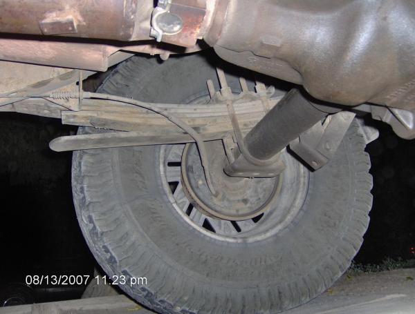

Here is a picture of mine.
Attached Thumbnails U bolt flip-1-crazy4x4rt-68656-albums-1993-dakota-5-9-4x4-105-picture-93-dakota-rear-axle-and-soa-springs-ra.jpg

4x4 and that was the plan. What is that plate right on the bottom of the axle?

That is the stock spring perch from when my truck was 2wd.

no spring pearches on top ?
what keeps you axle from pulling a Jack Chrisman?

There are spring perches on top. Just the lower ones are the stock 2wd ones that were welded to the axle tube are there since they don't get in the way, they actually helped aline the new upper mounts when first installing them.
