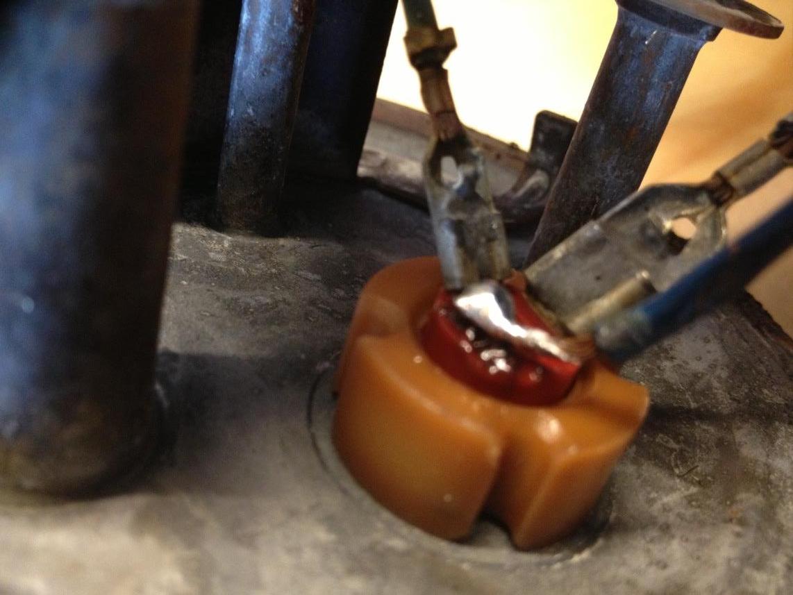

Welp there's why I was getting no resistance.
There's enough of the old tab showing to be able to solder a wire onto it, just clean that broken tab good before soldering.

Fired up the soldering iron I bought a year ago and never used. Did a few practice solders on some wire (never soldered before) came out looking pretty nice. So I decided to take on the sending unit wire. It ain't pretty but it appears to be strong and working. I did learn it's probably best to try to solder something that's not turned on it's side as the solder likes to run off.

To get solder to flow over the metal, it needs to be clean and then you need to use a solder with a flux. If you use solid core solder, you need to use a bit of soldering paste on the area you want the solder to stick. It will still drip off if the piece is really hot and you use too much solder. I'd be a bit cautious heating up a contact like that too much - you don't know what's on the other side. I just heat it up to melt and flow (with the wire there as well) and then take the iron away & let it cool.
