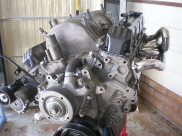

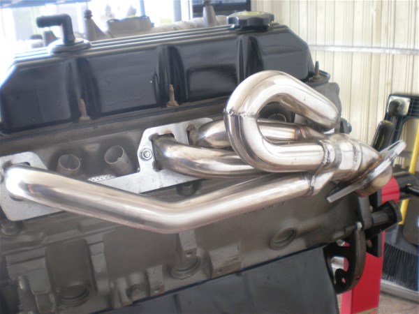

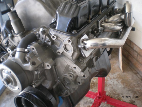

The block is cleaned up and painted and I've got the headers fully installed on the engine. A lot easier on an engine stand than it would have been in the car. Tough getting a wrench on the nuts that torque the header flanges down. As I mentioned previously, one of the exhaust manifold studs was broken off flush with the side of the block, it came out almost on it's own.

And the headers:
