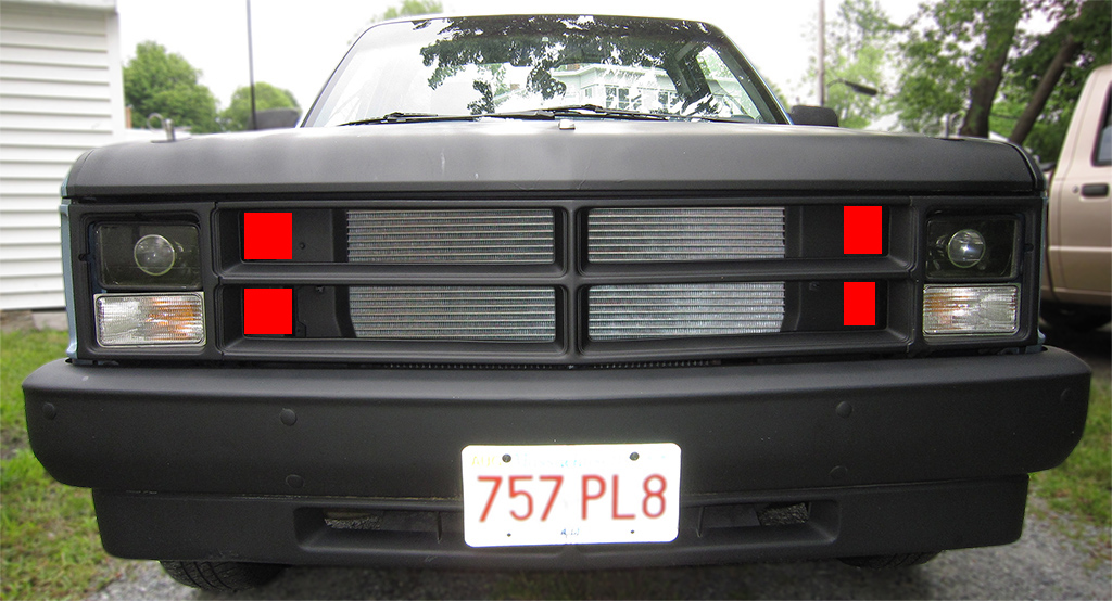

Installing the louvers regardless here is the other method I had in mind for outside air similar to the factory setup, pull from the red spots on both sides with again dual cold air cone filters. The red truck with the custom intake tubing would just have to have the last bends cut and dual boxes built on the sides of the radiator.

I'm with the man from Manitoba on this. CAI, where it draws air from inside the engine compartment, is a stupid idea. And a waste of time and money. The idea is to bring in cool air to the intake, and the stock air intake system does that. It sucks outside air in through a plastic duct--plastic is a better insulator than aluminum. And through an inexpensive, easy to change, effective air filter. Google and read the online criticisms of K&N style filters versus paper filters. But also, the stock intake is engineered to provide a limited amount of turbulance in the air flow--CAI is not.
If the idea is to improve your engine's breathing (and performance) you'd be better to get a bigger throttle body (bored out,) a set of headers, and a more performance oriented exhaust system.
CAI looks cool, but makes a lot of racket. And does nothing good for performance.

They are correct. The aftermarket CAI don't do much on a stock engine, stock intake.
Stock air filter setup is already a cold air intake. It takes in colder air (more like fresher air, since it is not always cold ouside) from outside then the engine compartment. Some Dakotas have the small metal plate removed to make the stock setup a CAI with a Ram Air setup.
Overall stock is great, upgrade the air filter and you will be at MAX air intake performance.

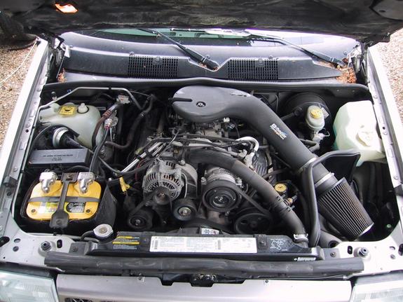

What about this style CAI on a Grand Cherokee with the 5.9L it has a box in the front corner which I guess is where positive pressure is built under the hood. The only other option I was told about was sucking air from the HVAC box under the cowl since all cars have a cowl in front of the windshield for positive pressure reasons, basically the hose would be shorter then stock and reversed through a hole in the firewall.
