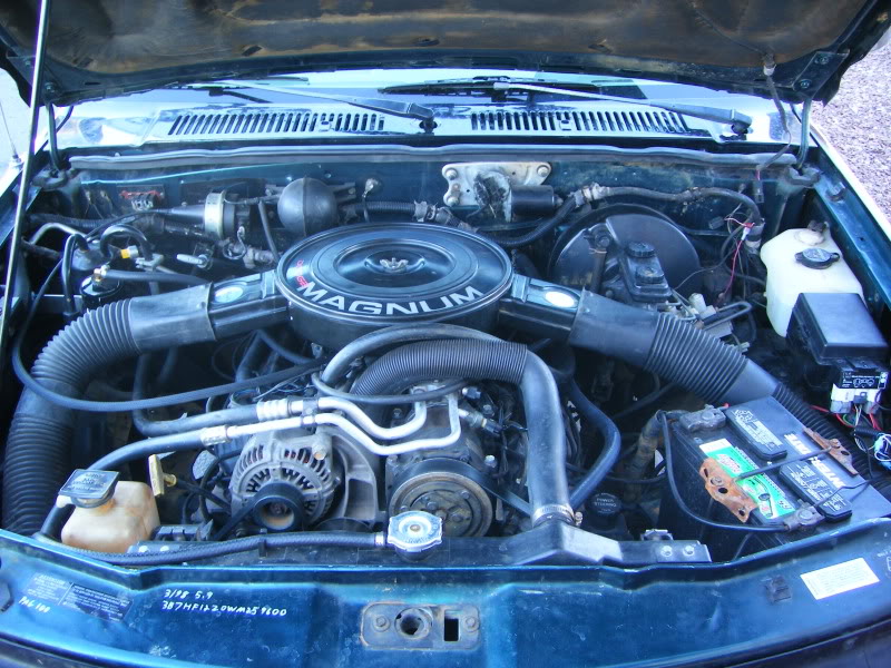

we have one or 2 guys on the forum who have done a dual snorkel with stock parts, but I'm with crazy and the other guys on this. Running a cone under the hood isn't going to net you anything but hot air. The stock setup can be ram air type with the plate on the core support removed. If your really dead set on the looks of a dual, try doing something like this first.
I am not set on the looks, only thing about the looks that drives me nuts is from the outside having a hole only on one side of the radiator. Would a stock-part dual plastic tube setup like that have any advantage or would it work harder now splitting the air draw between two tubes??

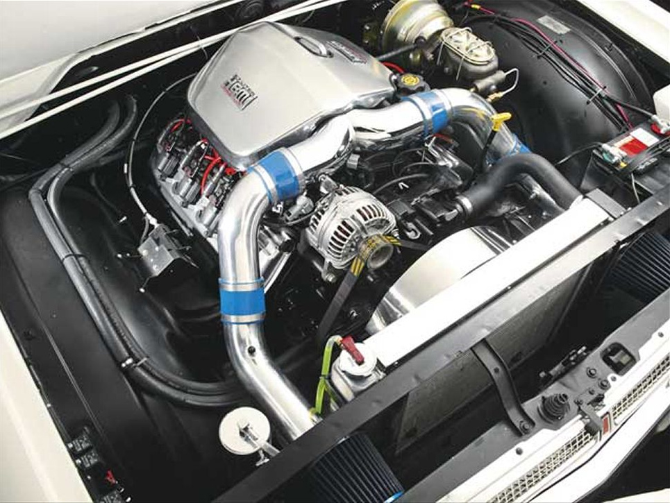

I just found this while browsing:
uhhh...wow..umm yea that could potentially work pretty good if you dont mind cutting your core support a little for round tube holes, otherwise the stock magnum tubing would work. My 93' core support has the intake slot on each side making it symmetrical, if your core support has that too only thing you would have to do is relocate the battery a bit.
Here are the instruction to that really slick set-up you posted a picture of: https://dodgeforum.com/forum/1st-gen...r-cleaner.html
I don't have room to do this, just throwing it out there. I do indeed have the dual intake square on my GenI core support I as thinking about just using both. I kind of like the idea of having the cone filter intake sound on acceleration though but if the cone was in a box I probably would not hear it anyway.

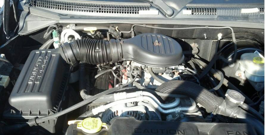

Just another "throwing it out there" this is another reversed Jeep setup:
lol sorry didnt quote you into that post AZ, by the way did you notice any difference after you set yours up like that?
And thats not a reversed jeep setup its just the Ram box, my dads old 01' had the box on the left like that.
Nope no difference. At least none that I noticed. I did it strictly for appearances. I gained by switching to the 92-93 exhaust manifolds with a true 3" exhaust, 52mm throttle body, and the kegger mod.
Exactly they use a reversed style as the Jeep lol
