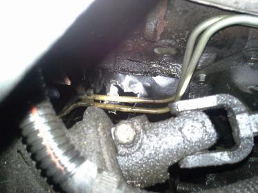

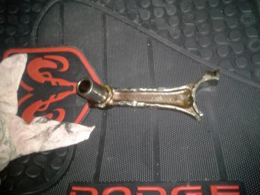

A few weeks ago my 99 Durango decided to throw a rod through the block

The 360 oil pan was destroyed when the engine blew up. Shot a rod right through the drivers side of the pan. Cracked the block at the same time. The other half of the rod is still poking through the pass. side.
