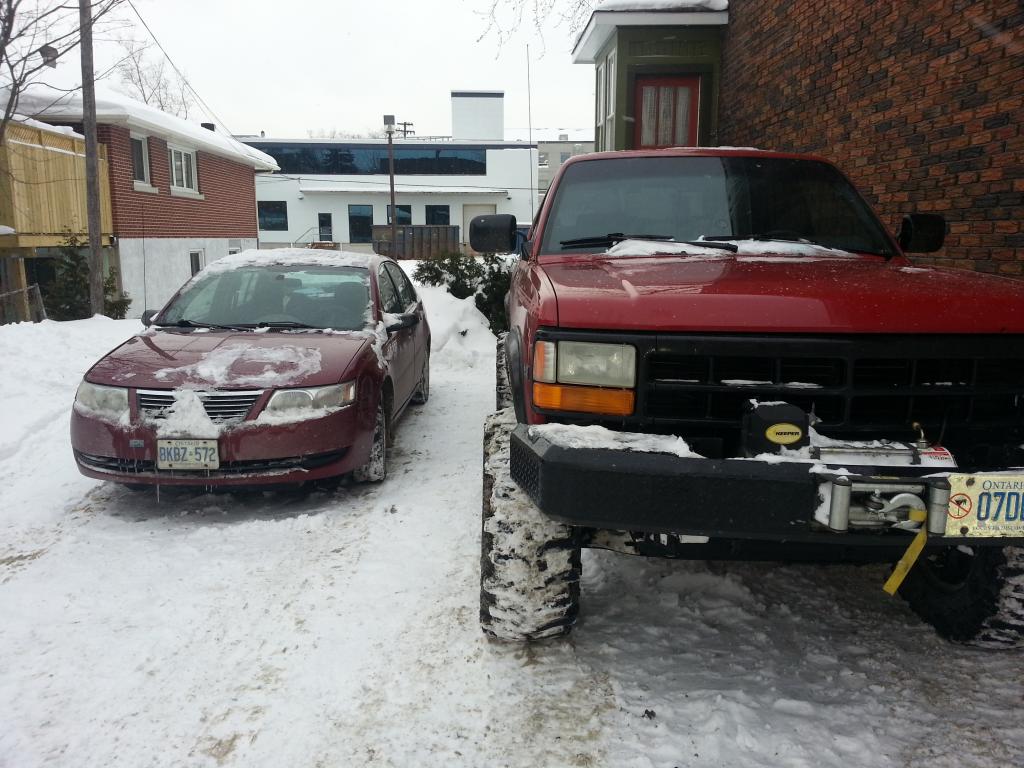

This Shows how the 15X8 rims 5.5 backspace with 1.5 added and 33X14R15 tires

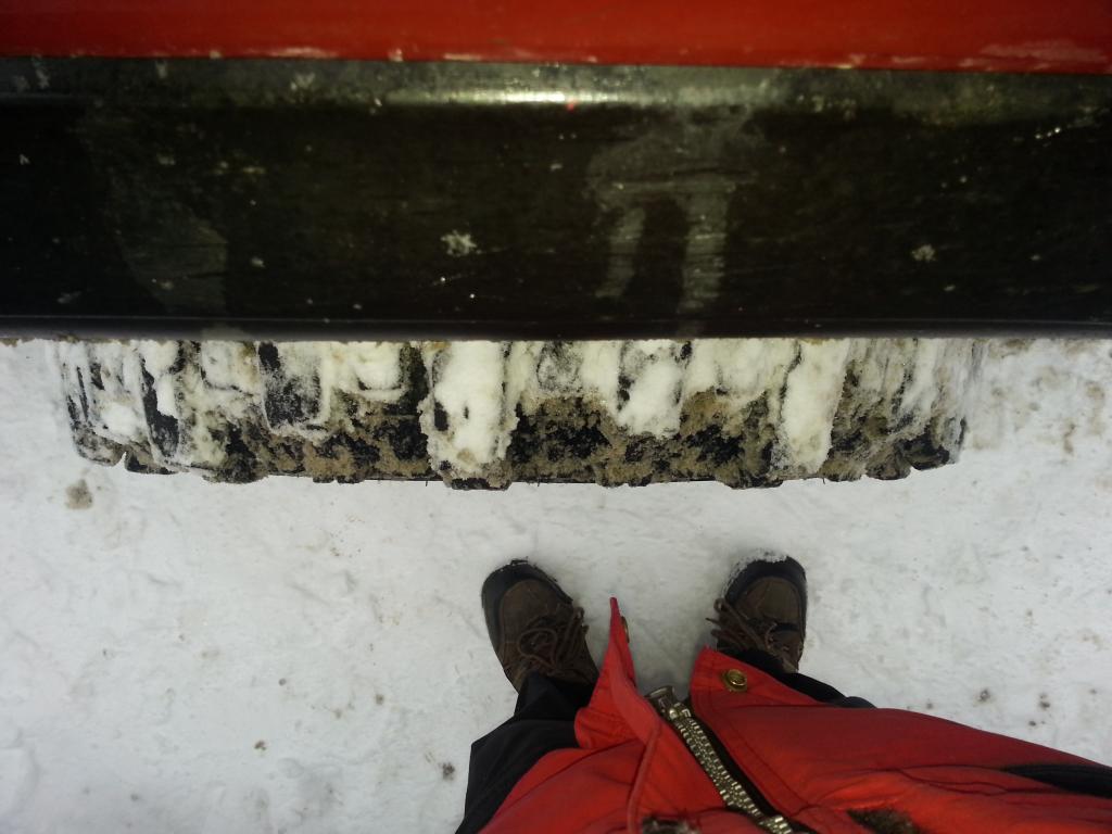

Vertical picture to show how far out from stock flares .... ^^^^

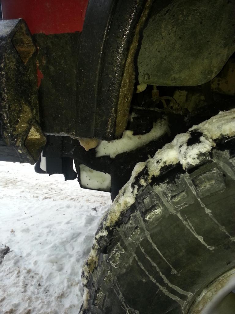

Shows front fender clearance with tire turned half way ^^^^^ so tire is at furthest pivot

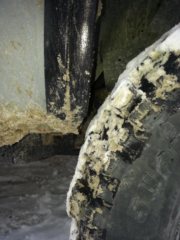

Shows rear fender side @ max pivot ^^^^^^ also gives a good indication of what I need to trim out before I can go out in bush and get that suspension flex moving ... .. also found this thread: https://dodgeforum.com/forum/1st-gen...html?styleid=6
