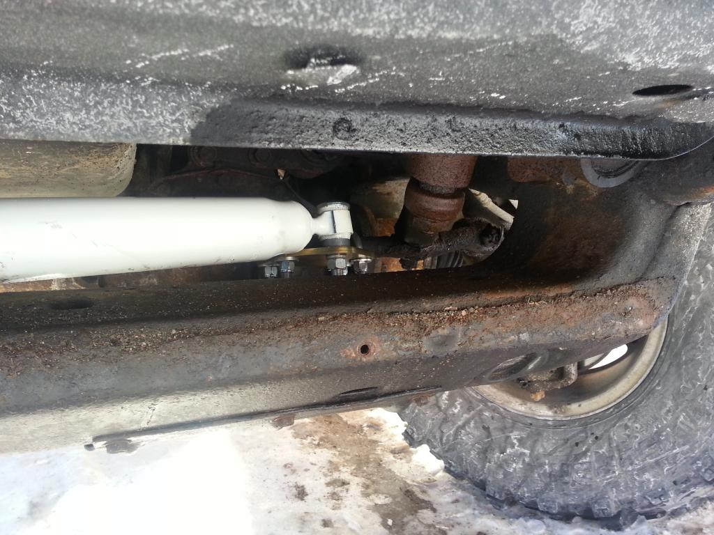

Anyway I think my Stabilizer is overkill but its originally from a 2000 4wd ford excursion lol pro comp part # 222570, it uses a procomp ES2000 stabilizer and its big....
As you can see in this picture I had to space out the shock for it to clear the lower cross member, but the bolt hole was already there and easy access to it via control arm pop out plug.tomorrow il get some metal and make a proper spacer .. stupid holidays.
This picture shops the plate/mount to the centerlink, it works nice but took a bit to get proper angle to it so mount wouldn't hit shock.... pic was before I got it to its final position.
