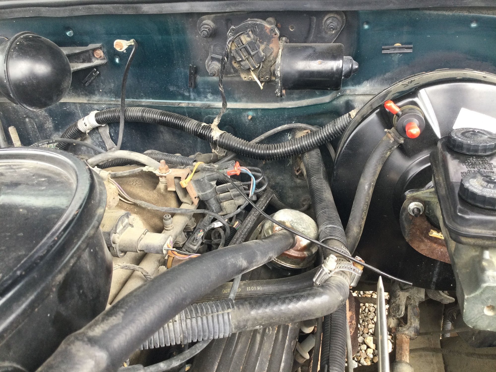

Do you have a more exact image of where in the firewqll that vacuum line goes? I'm not sure where it goes after the tee. The screwdriver is pointing at the end I don't know where it goes.

The pic in post #3 shows line entering the firewall on the right of the brake booster at 3o'clock. I went and looked at my 94 3.9. I cannot see where it connects but it dives down under the brake booster. You may need a trouble light and a mirror or a rubber neck. I looked in the 94 and 95 FSM's and if there is a diagram of where it enters the firewall I can't find it.

Thanks I will do my best I appreciate you looking all that up
