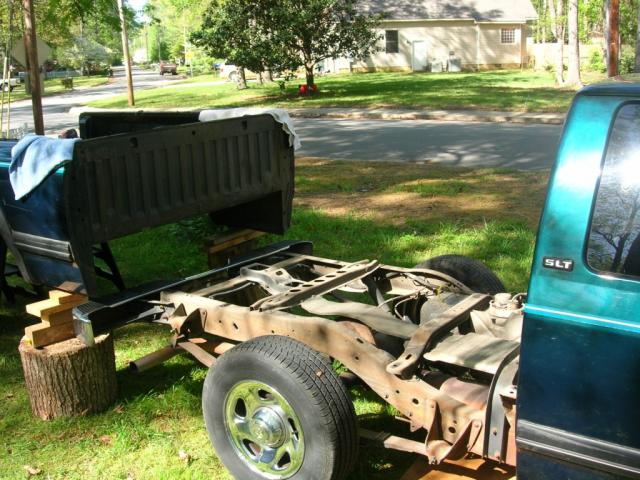

My fuel pump went bad in my 1995 Dakota and the cause was not obvious. I had stumbling at high speeds and once the engine warmed up. After replacing enough items, such as you have, it started to become obvious that it had to be the fuel pump.
Your fuel pump is 10 years old, I see no particular reason why it has to be perfect. I think there are more reasons why it should not be good. I was unable to measure fuel pump pressure under load, just at idle and increasing RPM's in the driveway. I believe that if you could measure pressure, or volume, under load, the load of an acceleration for example, you would see that the volume of gasoline delivered by the pump is insufficient.

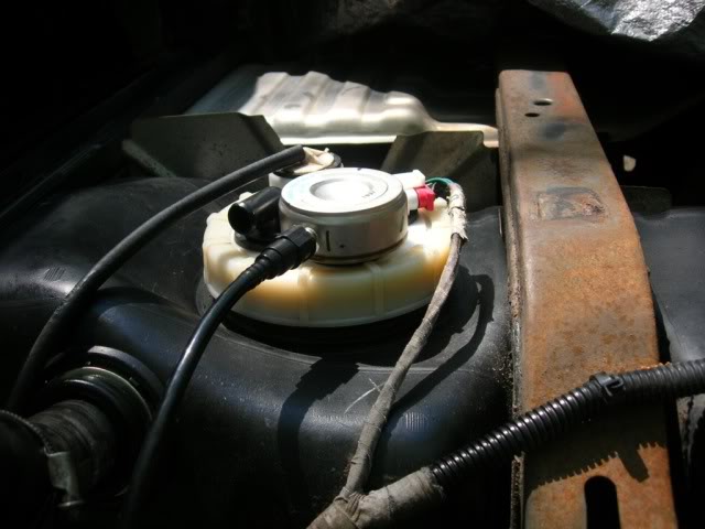

From the helpful guys here on this site, I found the best way for me was to remove the truck bed to gain access to the pump. There are about four or six bolts, tail light cables to disconnect, fuel inlet hose, and you need another person on the other side to place the thing on sawhorses. Then you can get access to the pump.

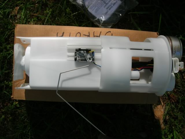

This is an AC/Delco Chinese made fuel pump. I think the filter element is too small, but since I had the thing, I used it.

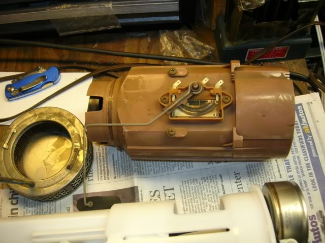

This is the original OEM pump and filter.
