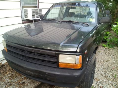

He decided he was gonna scrap it. I wound up picking it up for $400. It is rough, and still not running.
I threw my code reader on it and I'm getting "no link." This tells me its either computer wiring or more likely fried computer. Thoughts?
It also did have no battery in it for 3 hours prior to trying to check the codes. (The seller took his battery).
