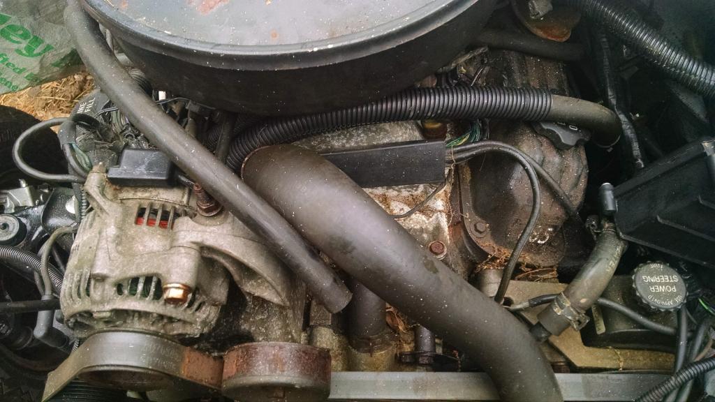

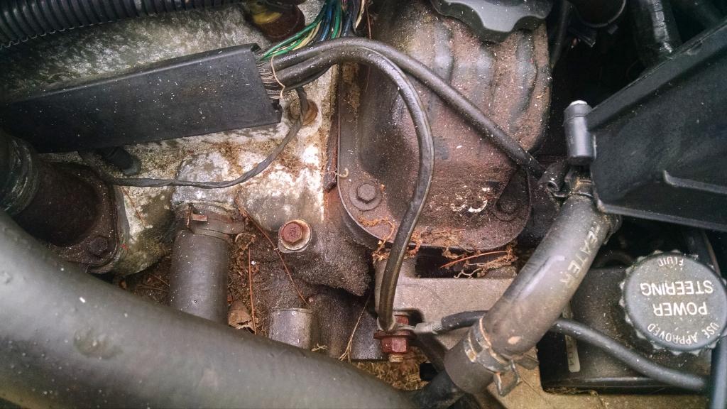

On my truck, the larger ground wire crosses in front of the motor and is bolted there. No clue about the smaller wire.
Thanks for the pictures. I decided to place the grounds on different locations since the cables were moved around and they won't reach where they were before.
