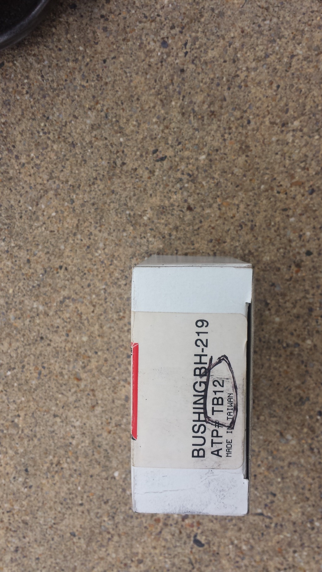

OK, I wanted to add the part numbers that I believe will work.
Chrysler 2801726
ATP TB-12
Napa 14590
Pioneer 755102
old Chrysler no. 2538525
Bryco 49637
PTC BH219
I "think" this is the same for the 231 case as well.

Ragged89, thanks for your reply and links.
By using the part numbers above I found a ebay dealer. Paid like $3.87 for the bushing and $6.00 shipping.
FWIW, the difference on the inside dia. was only about .003 but it did help with the viberation I have been having.

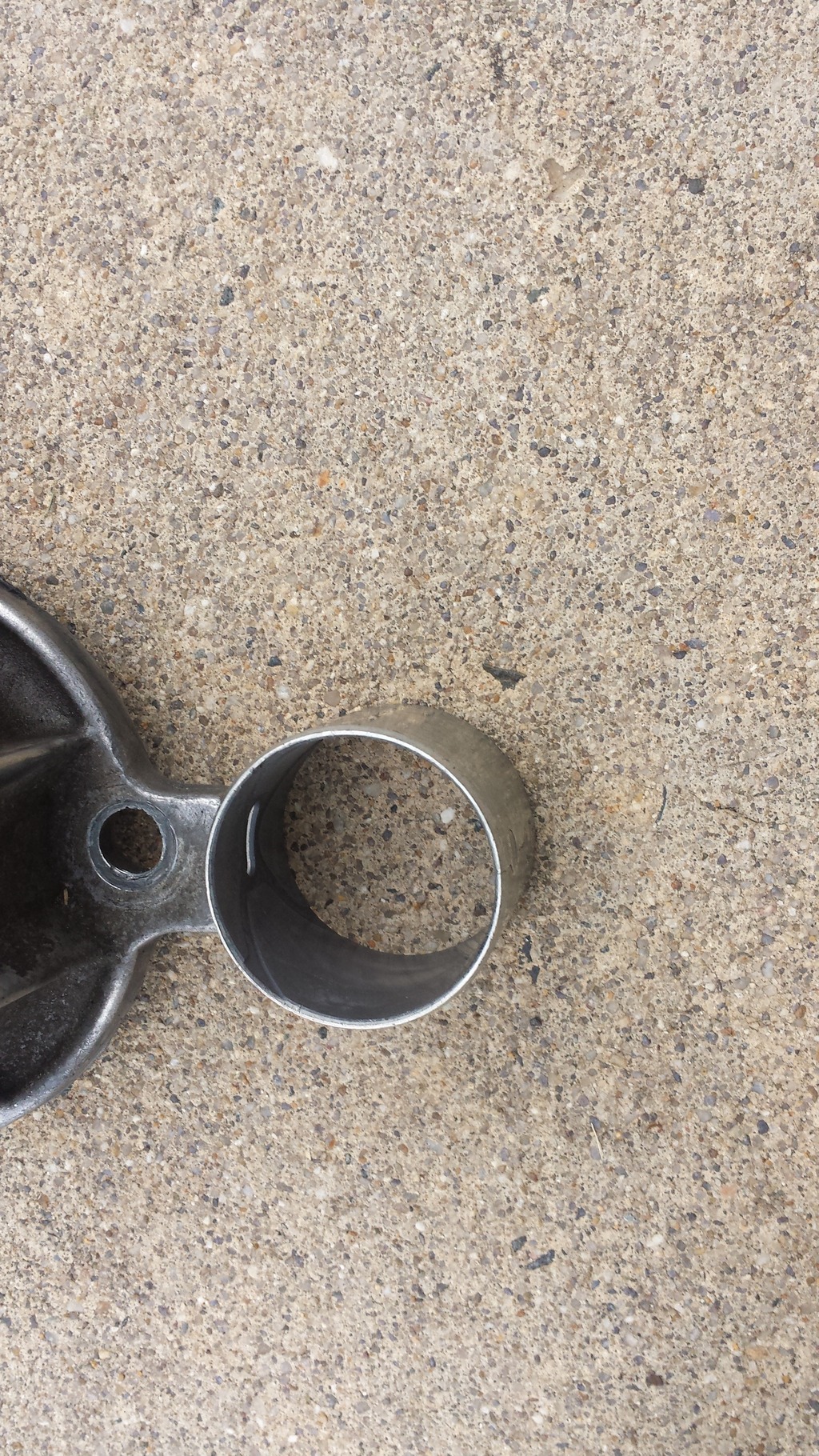

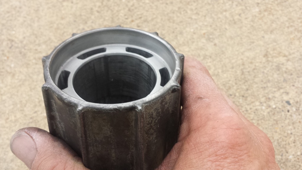

I still think that part of my problem is coming from the rear.
I think I have everything to switch it out now, so that is my next adventure!!
I took a few pictures. Thought I took one of the new bushing installed, but its not on my camera, so I guess I did not. I used a socket slightly smaller then the OD of the bushing. With that socket I pressed out the old bushing. Then I used a larger socket and pressed in the new bushing.
I was going to buy a set of bushing drivers, but I did it with my press instead. Not the best but it worked.
Here are a few pictures.
