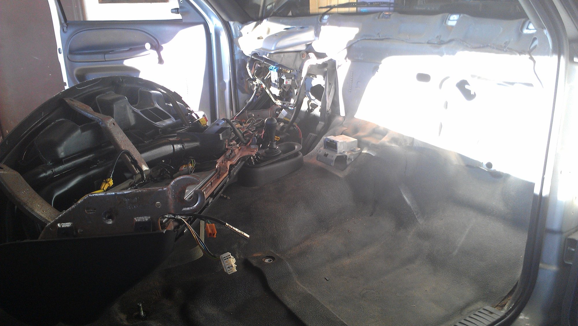

Default 1999 Dodge Ram 2500 dash removal to replace A/C core
Yes, the operation is not pretty, but not that difficult. To make sure you have enough room, be sure to take out the seats! On our 1999 Ram Quad cab, (yes, not a gen 1 Dakota, but thought the pic was cool!) we had to remove the steering in order to drop the dash.
