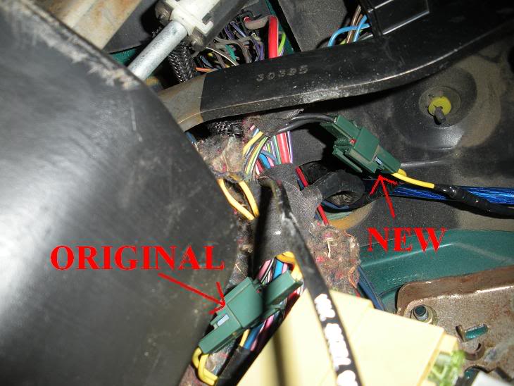

Alright I know this already has a thread in faq2 but I need some information not listed in that thread. Specifically the wiring.
Picture from our existing thread that highlights wires in question
The green plugs is where I'm having my questions - went to the junkyard last 2 days to get parts from my wifes saturn, but stumbled upon a mostly intact 95' Shortbox dakota with the i4 and ax-15. I was able to pull the entire slave cylinder assembly, shift stick, floor plates, boot, trim piece and full pedal assembly. I got the green plug that is attached to the pedal assembly, but that truck was a 95, and had all the wiring under the dash. My truck, is a 93'. I can't find those green plugs under my dash anywhere. Will I need to trace the wires on the donor truck and add them into my wire harness? If so where do those plug in so I know how much of the donor harness I have to tear apart to pull them?
