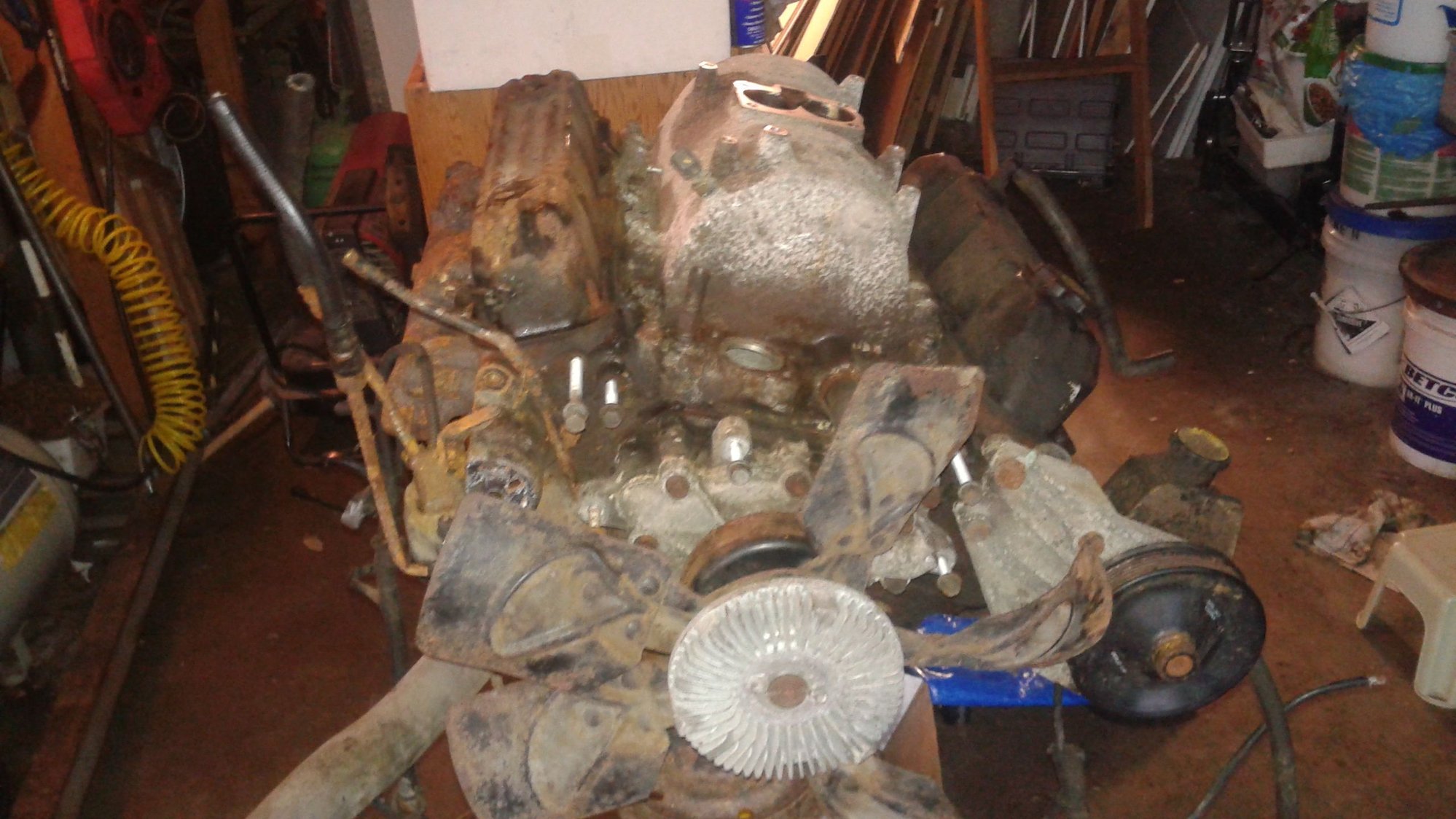

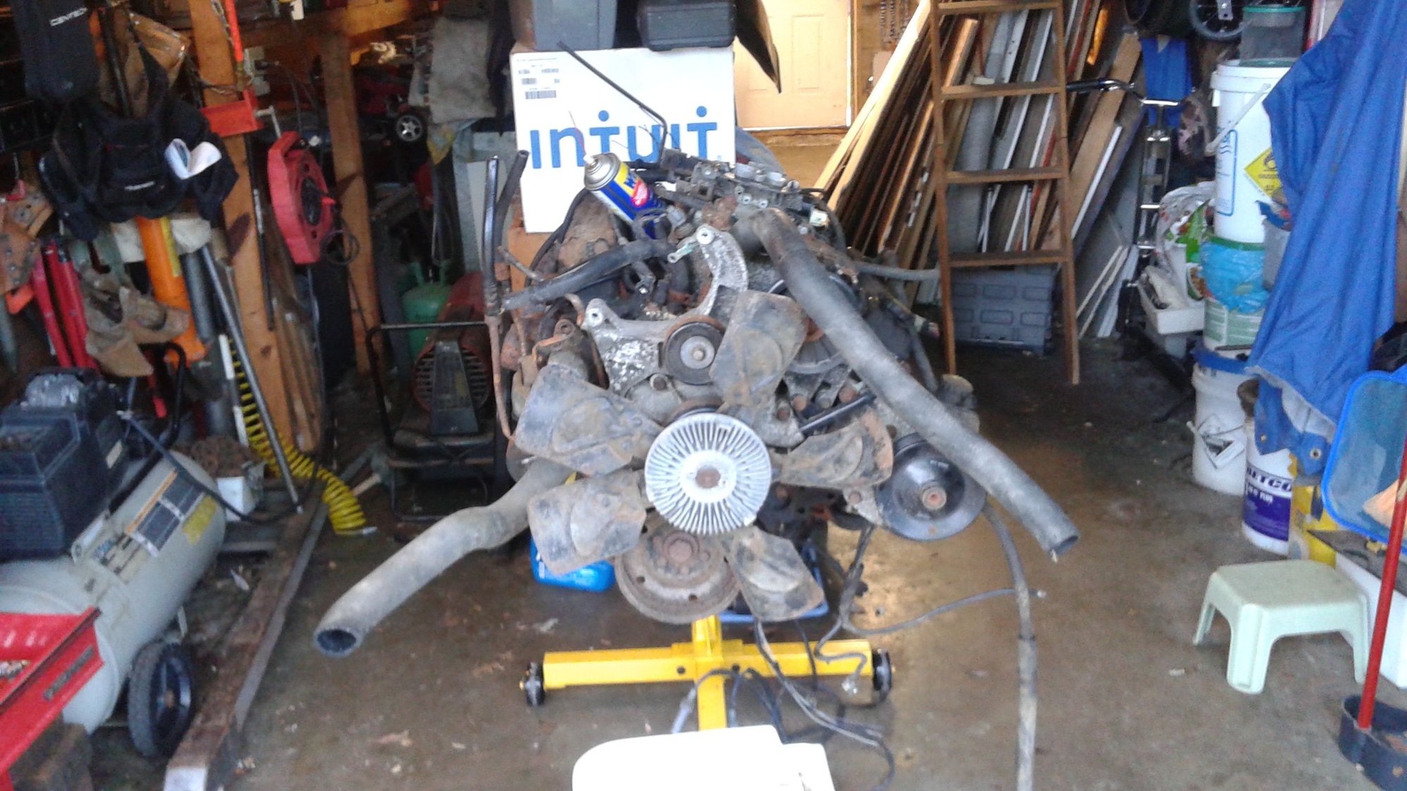

Got the engine on a stand.
Drove 200 miles to Peoria, IL to get it, on the last 5 miles I saw smoke coming from my transmission. I think I blew a seal,it leaks whenever it's in motion. I'm driving a PT Cruiser for now.
Before I got to it
Taking off everything I wont need.
Same as before

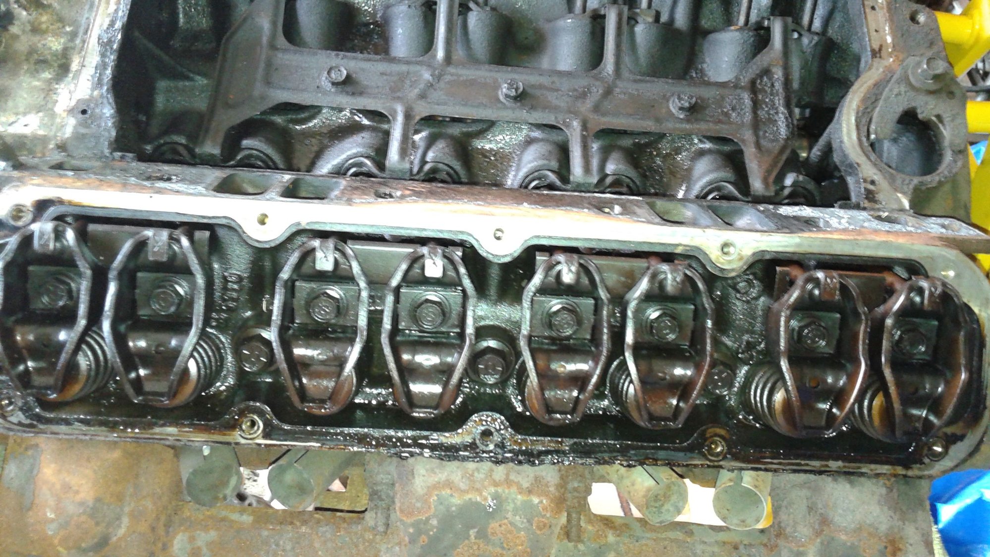

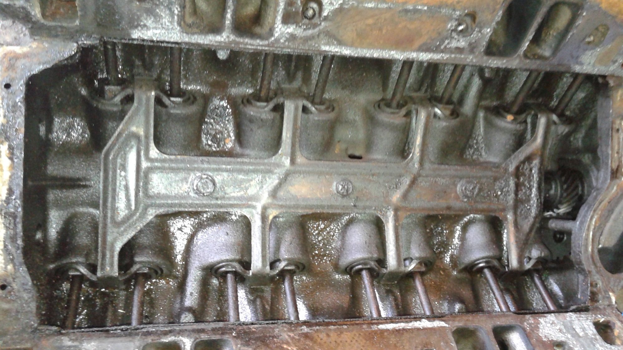

I was taking off the intake manifold, and a bolt took a bunch of oil with it, then the smell hit me. This thing was eating oil bad. I'm hoping the block isn't actually cracked.
The two front bolts lost their heads, so now I have to find a way to get them off.
Rockers look clean

The plenum gasket breaks down because of the dissimilar metal of the steel plenum and aluminum intake which allows oil into the intake where it burns and causes lots of trouble. That may be where the smell is coming from. There are after market plenum kits, if you get one make sure the one you get has an aluminum plenum that is at least 1/4" in thickness. I went with Hughes engines they give great phone support. I can't see where the bolts broke off.
My first thought too, the moment you mentioned the smell! A plenum kit will solve the problem.

I've done the plenum on my 3.9L, and this one is just as bad. The plenum is very shot on this engine ( can't even see the metal anymore ). When I was unscrewing the manifold, a screw came out caked in oil, and the smell came from the hole. The screw never went near the inside of the barrel intake, so I'm wondering how it got in there, probably a bad gasket. I plan on putting in the Edelbrock FI airgap kit.
