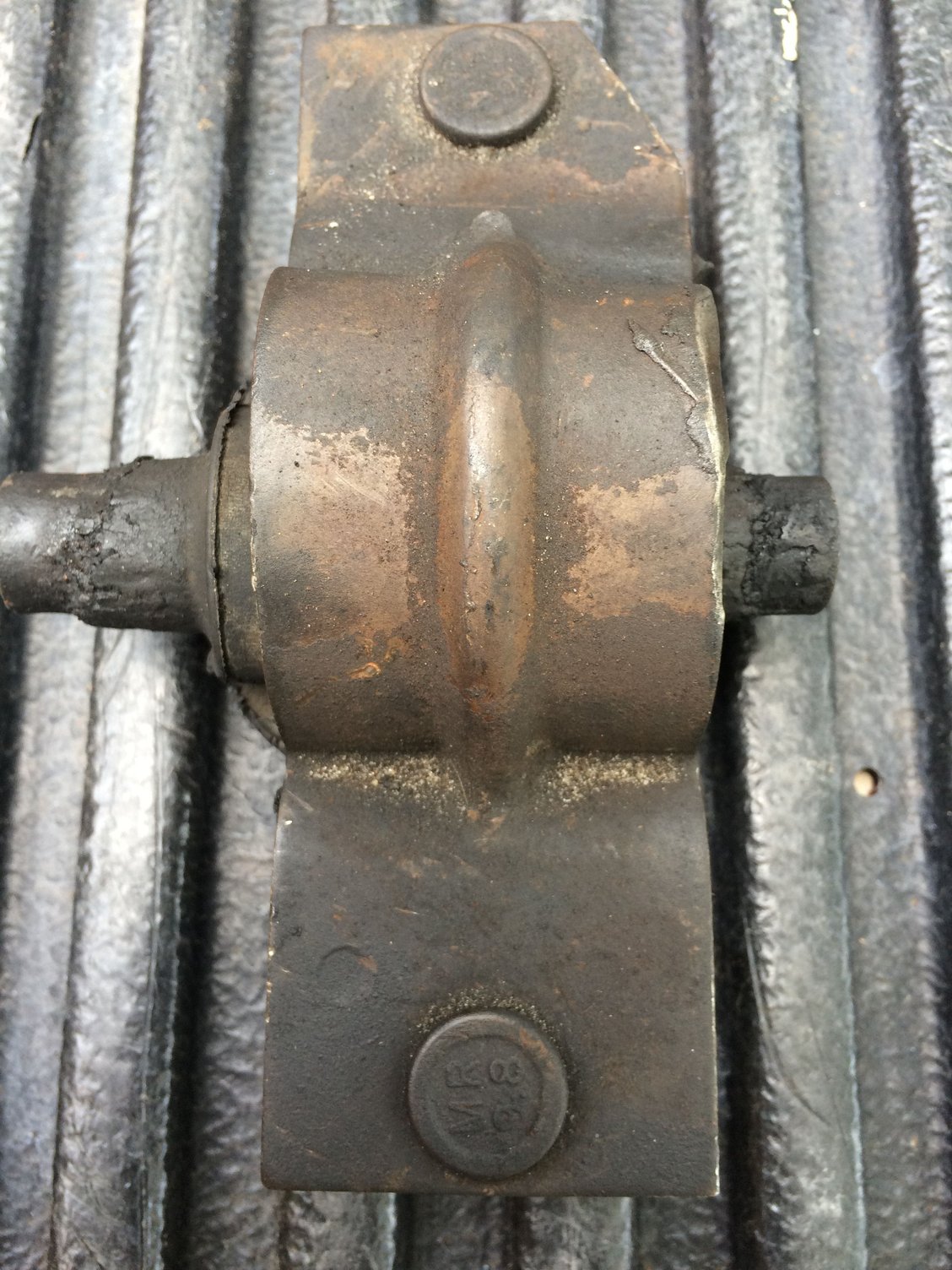

Your right and I pulled the transmission bracket(4412154) to verify its correct. There is no adjustment of crossmember so stumped at my misalignment issue. See attached images.
See where it's rubbing the bracket on the left side
Notice how it is protruding from the left side
Bottom view
Bottom view
I'm not near my truck as out of town but that mount doesn't look like mine. But mines also a 1990 42rh so dont know if or when it may have changed.

Update on my Transmission mount issue, went back to the shop who rebuilt my transmission for any help and no luck there. Somewhere along the way something got tweaked that is not noticeable to the eye. The only way to truly find out is start replacing brackets and go from there. So the work around was to modify the crossmember to fit the new mount. Attached are photo's of my mod to the crossmember.
Hard to see but the mount now lines up with the bracket without any side load
Not happy about this but this is what it took to get the mount to line up with the tranny bracket
