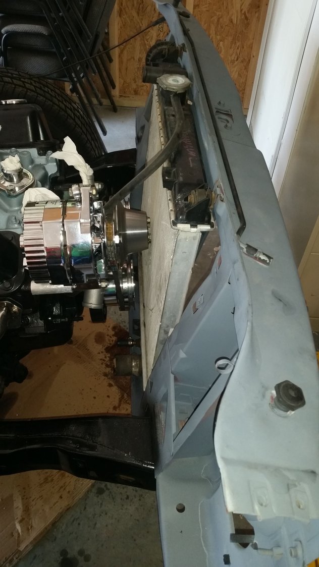

Well, I think I've stumbled upon a standard issue for those of us doing V8 swaps into our V6 trucks. I remember in the FAQ reading Siggie's build thread and he had the exact same problem, but at that the time noone really knew why. I know why, unfortunately. The 360 magnum carb motors (same one he used) come with an LA timing cover and water pump setup in order to have the mechanical fuel pump setup. The LA timing cover/pump sets the front Pulley much further forward than a V8 magnum from a Ram/Dakota which uses the Magnum timing cover/water pump. So, any radiator that sits in the original slot, even a thinner one, won't work. You can see from the attached pic (I have the core support leaning forward just to fit the radiator in for a picture).
So.....I think my only option is to recess a radiator in the opening. My concern with that is fitting the pusher fan in there too. Swapping the front end isn't an option, and I really don't want to change out the whole pump/timing setup, which changes the belts too because the magnum pump runs opposite direction. I'm going sans AC so I should gain a little space in the core losing the condenser, but I just don't know if it will be enough.
Any suggestions?

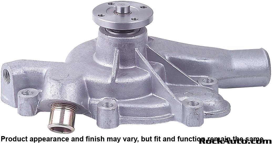

PICS are different, look at what a 1989 3.9 water pump looks like:
And then the Shelby water pump:
Different part numbers, different appearance, all in the shaft.
It might be the same for the 1990 3.9, but RockAuto's cross has the 5533111 for a 1990 3.9, same as my 1988; not the 5533134 that they list for the Shelby. Both Cardone numbers.
And I just checked, Cardone.com ( https://www.cardone.com/find-parts/v...kota&year=1990 ) lists different pumps for the 5.2 and the 3.9, for the reman'ed and the new.
For 89 they do list the same; there may be a difference in the mounting, too.
But the 1990 Shelby pump does have a shorter shaft, which would take care of part of it; are you sure that the water pump you have is reverse pump? That normally goes with the serpentine belt; the V-belt is forward pump (like the old LA pump), since the belt goes the same direction around as around the crank pulley (the serp belt is sometimes, like on my Cougar, run the other way to make the belt work.)
RwP
