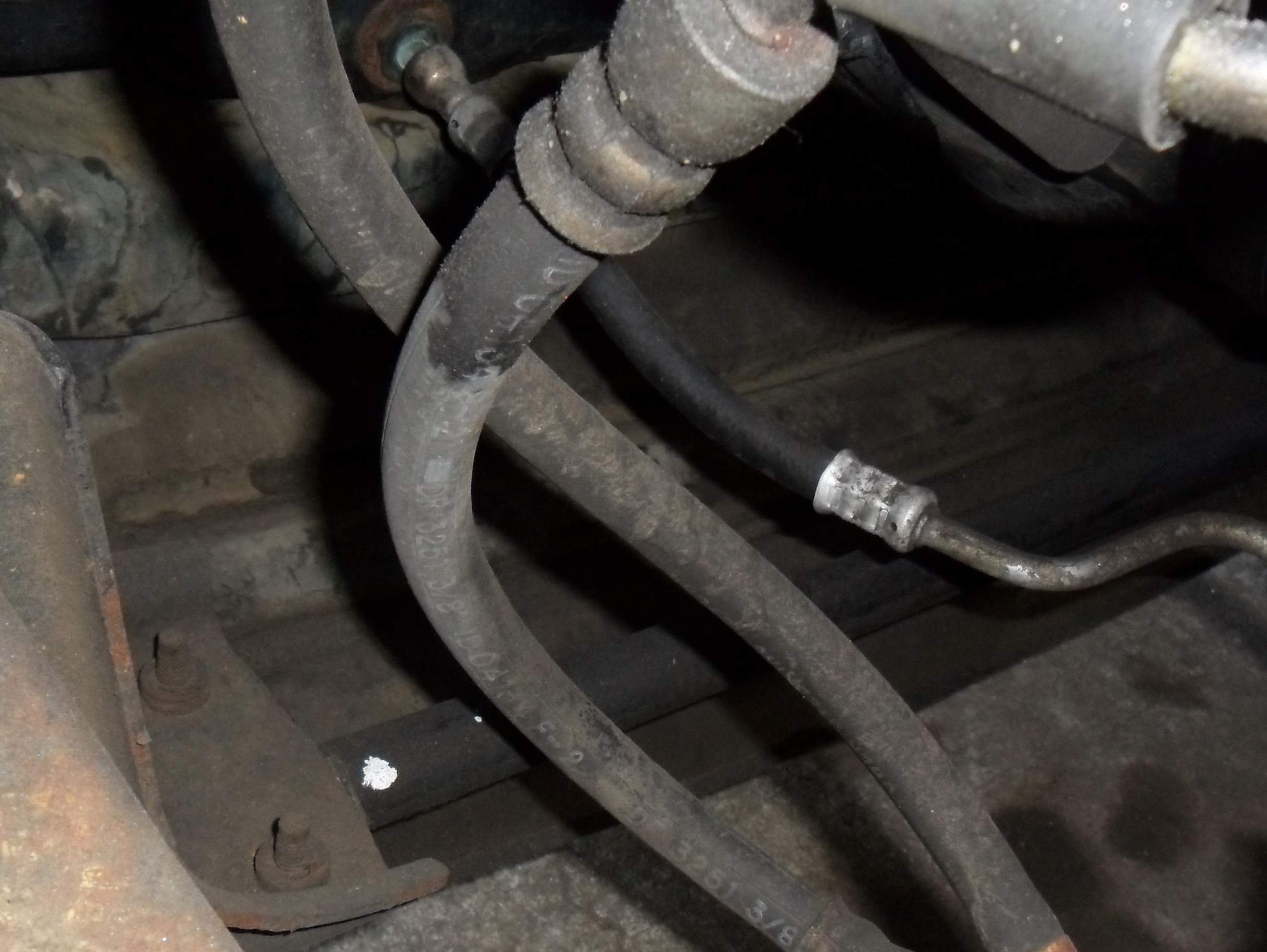

I have the new rad but it looks like the tranny connections are going to defeat me. I have a pic of the one I can see. I don't see how that connection works but I'm guessing it is done with a compression fitting tool. The other side has a threaded fitting back where this line goes from rubber to metal.
Am I mistaken or ???? I don't want to take it apart then find out I can't replace it.

Just found this which shows the fitting is a push pull connector. You push in the hose and pull back on the end piece. Hope mine doesn't leak like his did

OK got it done.
I found this vid just after posting the last post
I went directly to AZ and bought the tool that looked like it would work. No one had any idea what tool might be for a Dodge. It did not work. I tried several stores on the way back. No joy. I went to Napa and the guy had just done one himself and showed me the tool then told me I could grind it down if it was too big to fit. I needed <1/2" long to fit in the space before the fitting. I did so and it came right off The key here is that he has experience and knew the tool did not have to be as long as it was to work. Pic of tool after I ground it down and used it below. I tried making a tool like this guy did but it didn't work.
