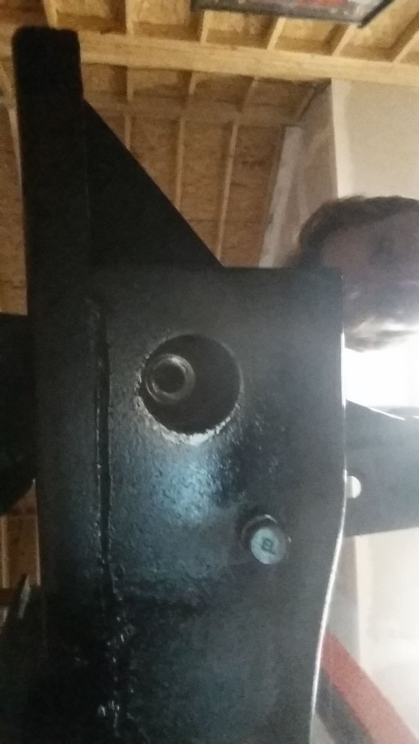

Well, I figured out where Dodge found the extra 3". They boxed in the frame on 91 and later and drilled an extra hole. Sunofabiscuit.
Here is an underside picture of my 90 frame, looking up and you can see the hole in the bottom of the frame for accessing the bolt to the radiator support.
Then here is an underside picture of my 95 frame. As it turns out, the frames are identical in length...BUT, Dodge boxed in the top of the frame so they could drill a new hole 3" out for the new radiator core position. Hard to believe noone's documented this in all the front end discussions.

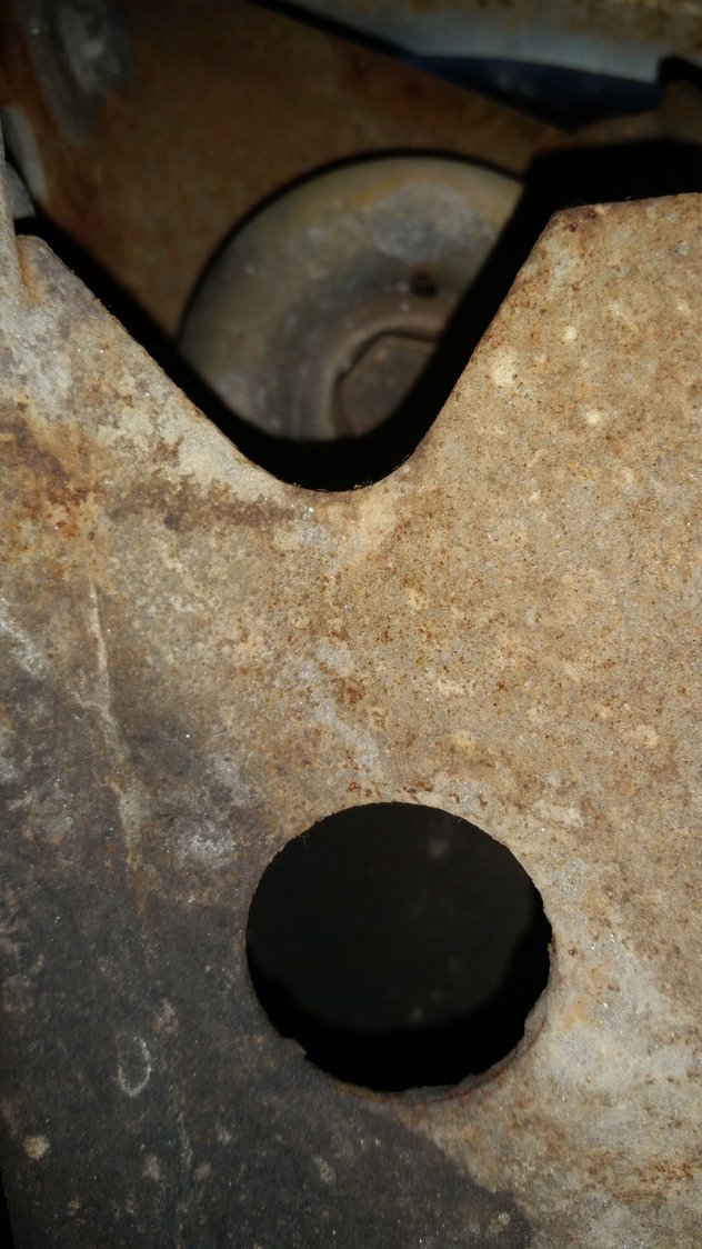

So now I have to figure out if the bumper mounts stay in the same place or not. Because if they do, then I should be able to box in the top of the frame and add a hole for the radiator support. I was thinking at first, no way not enough support, but that's all Dodge did. Their radiator core is only on a piece of unboxed top frame. You can see the notch that allows access and the bolt is beyond where the lower frame ends.

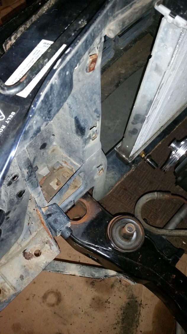

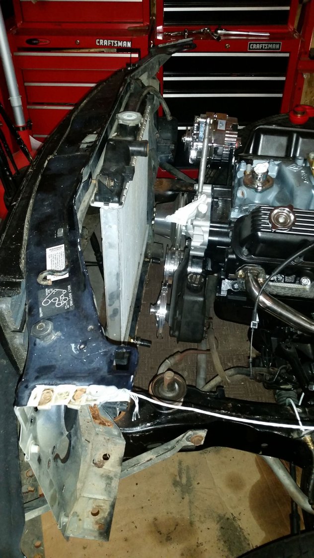

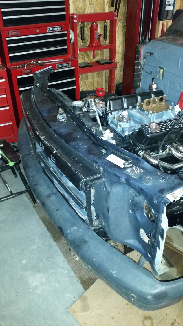

So, I mocked it all up....I think the plan is to weld a piece on top of the frame, finishing what Dodge did in 91, cut a hole for the bushing, and be good to go? Thoughts????
Old Jul 30, 2016 | 05:59 PM
  #26
robertmee's Avatar
robertmee
Joined: Aug 2013
Posts: 1,033
Gives me a ton of room now

That's a 94 bumper on there with the supports....all seems to fit

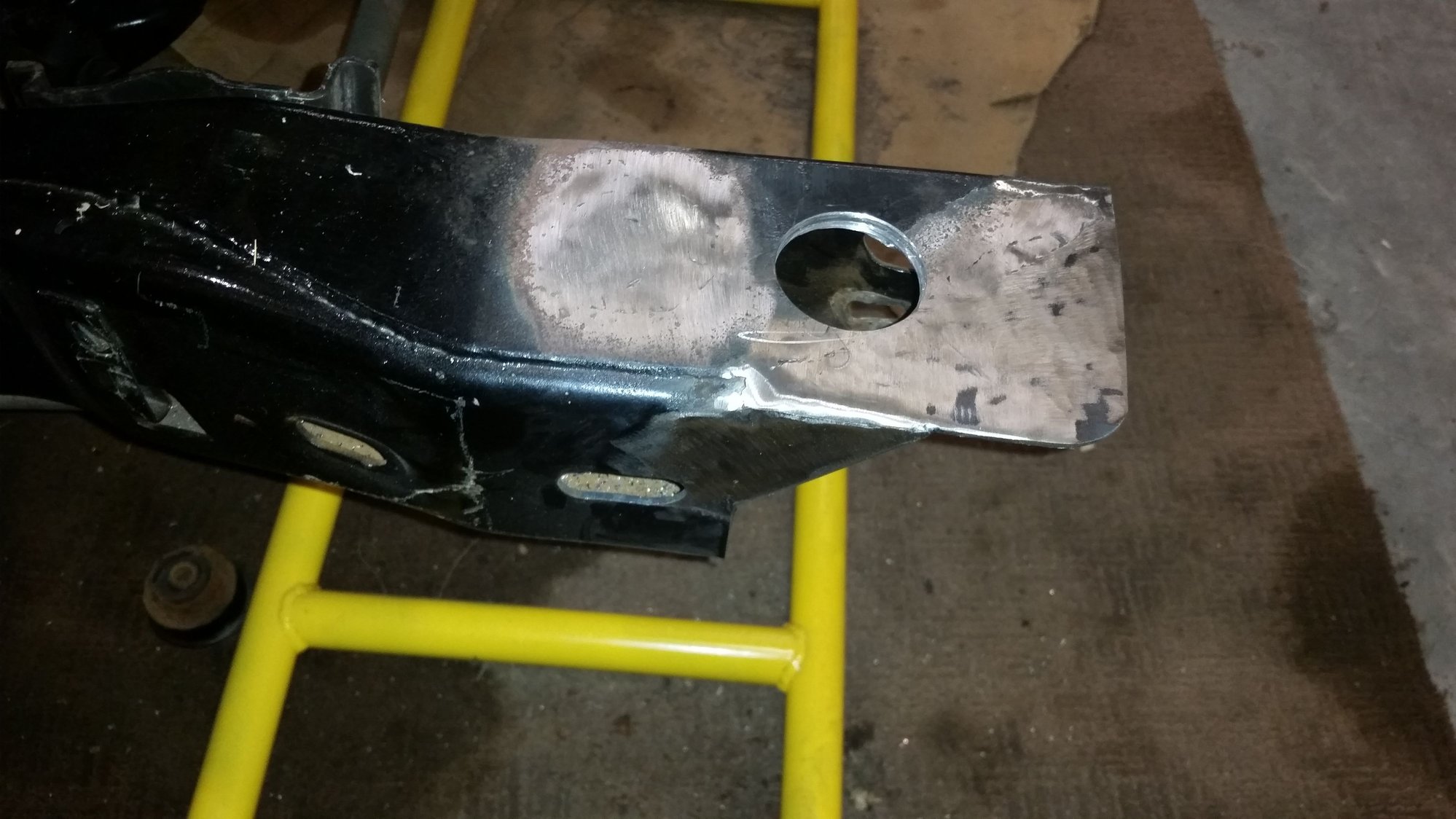

So here is the result of boxing in the front and redrilling.
