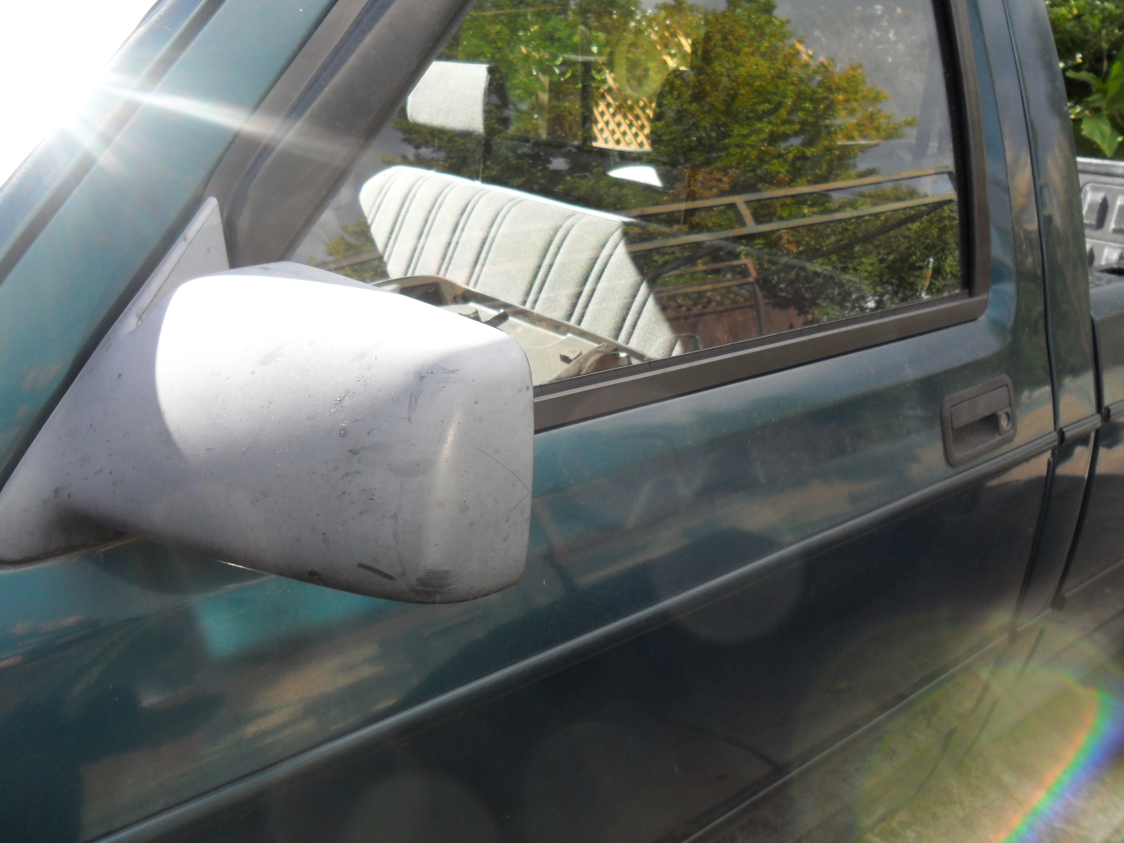

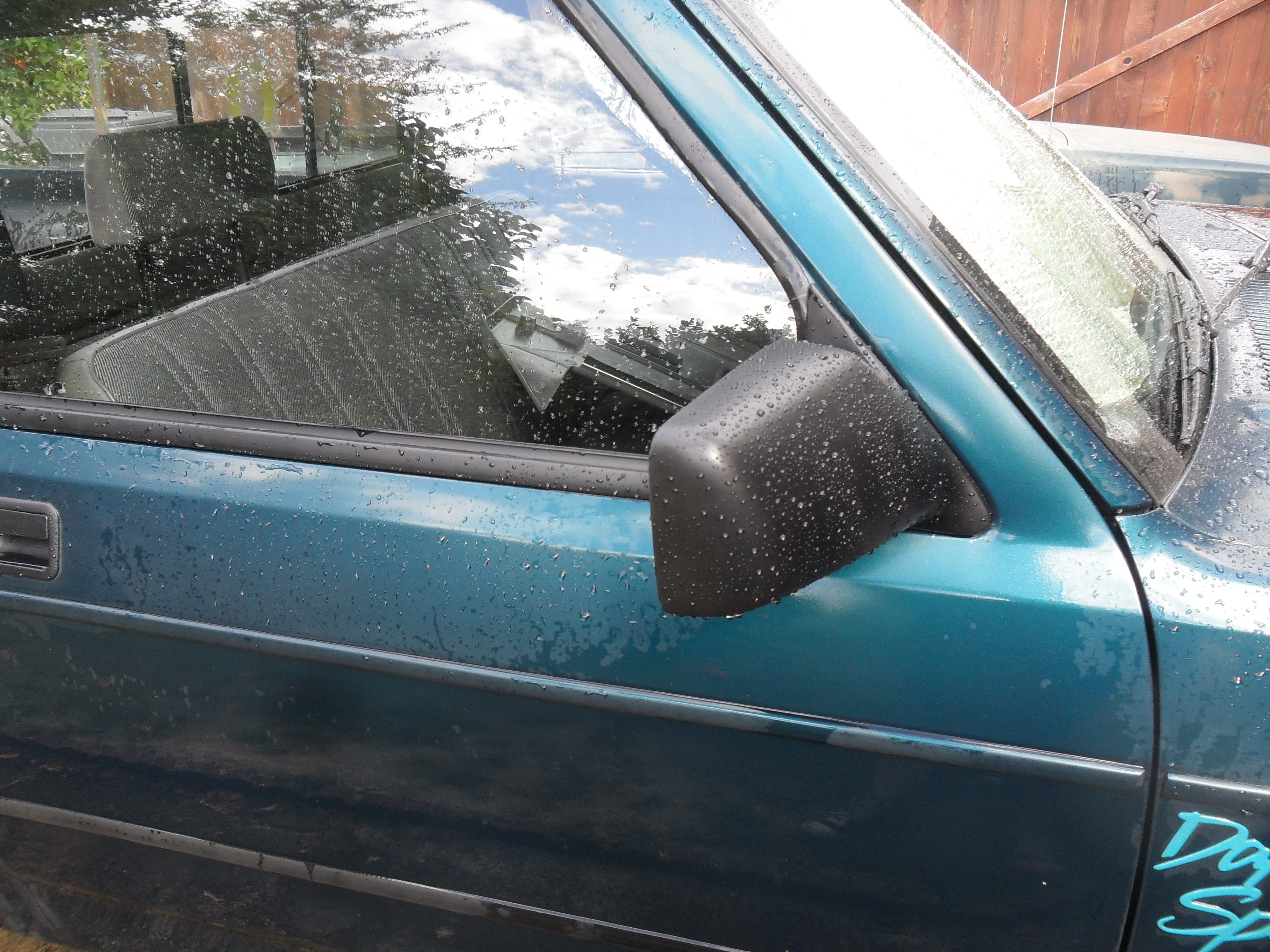

I painted the mirror. Cleaned it, Sanded it with 220, primed sanded 220, primed twice more then two or three coats of paint and two coats of matt clear coat. I added a pic of the driver side for comparison.
