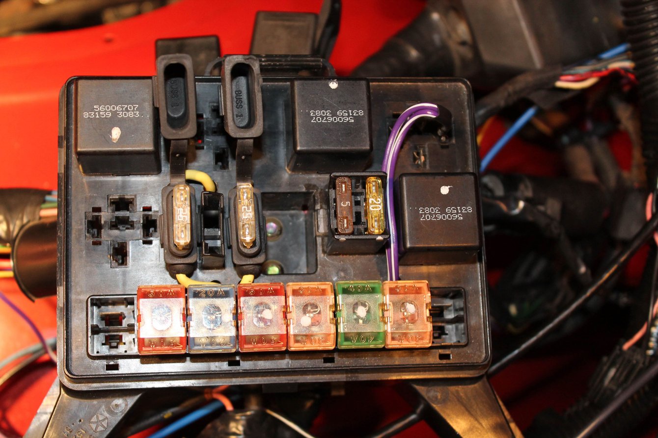

That's a nice, clean looking box that Robert chose. If you need more relay real estate, look at the boxes in the later Dakotas. I went with a factory box from a '94 Dakota, mainly because it was attached to the '94 wire harness I pulled from the JY! Dodge calls it a Power Distribution Center (PDC), but I like it because it has 6 relay sockets, and 8 large fuse sockets. You can pull extra female pins from another box and customize your PDC the way you want it. You probably saw this pic in my build thread, but anyway:

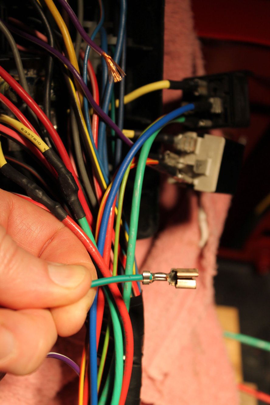

Here's one of the female connector pins pulled from the PDC:

Sorry for the delayed response! Orig. I was thinking something like Robert posted being what I wanted, But after thinking about it, what Ragged come up with, I think I like better. I could have all my relays, fuses, etc. for my fans, fuel pump, and anything else needed in one location.
