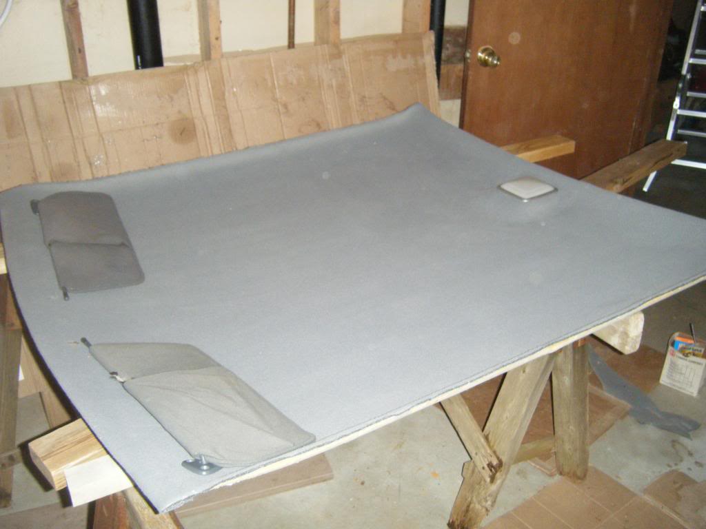

I redid mine in BO-RING stock gray. Jo-Ann's fabric has excellent headliner material, thicker than OEM and non-saggy.
Good to know mine is sagging everywhere except where I sit which is why I haven't done nuttin yet What size piece did you get tbugden?

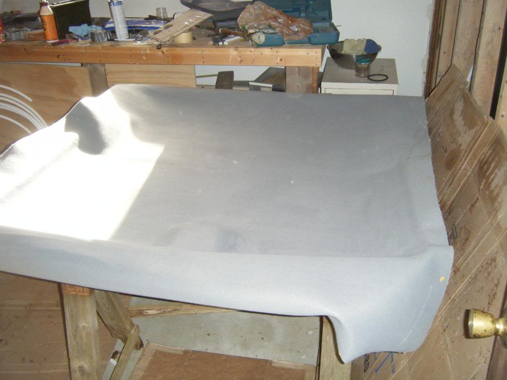

I forget what the width is but I guess it's a standard fabric roll width. Length I think I got 2 yards which was the perfect amount for my extra cab. I purchased this stuff called Fast Tack Upholstery Adhesive at Jo-Ann's which shoots like a spider web and it worked AWESOME.
