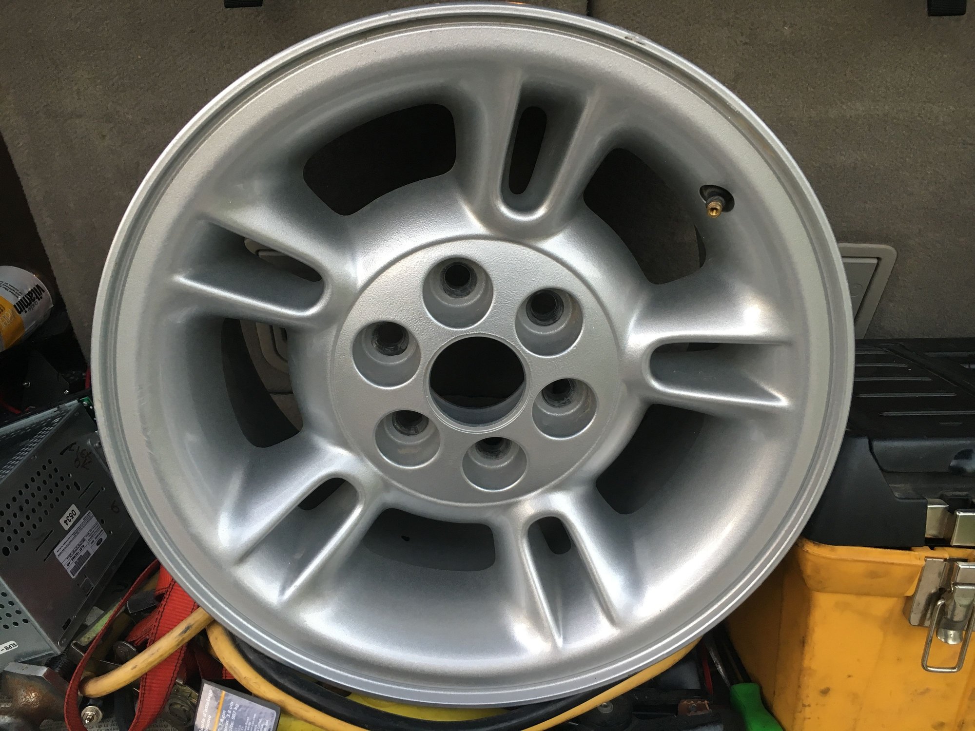

Hi Guys
I want to put different factory rims on my Dakota. I already have to of the 15 inch rims. I am having problems of finding the other 2 rims. I went to a salvage yard couple days ago. I didn't find the 15 inch rims. I found a set of 16 inch rims the same style I want but don't know what size of 16 to run on the rims. I can get the 16 inch rims for $35.00 a piece. I was going run a 235/75/15. Can someone tell me what 16 tires I can run on my 94 Dakota?

Well, Tirerack.com says the 16" factory Dakota rims were equipped with 255/65-16 tires. 15" rims came with 215/75-15 or 255/65-15 (again according to Tirerack). A 235/70-15 would be a reasonable substitute; a 235/75-15 might be a bit on the tall side, compared to the factory tires.
I believe the wheel in the picture you provided is the 15". The 16" are similar, but the spoke design is slightly different.
