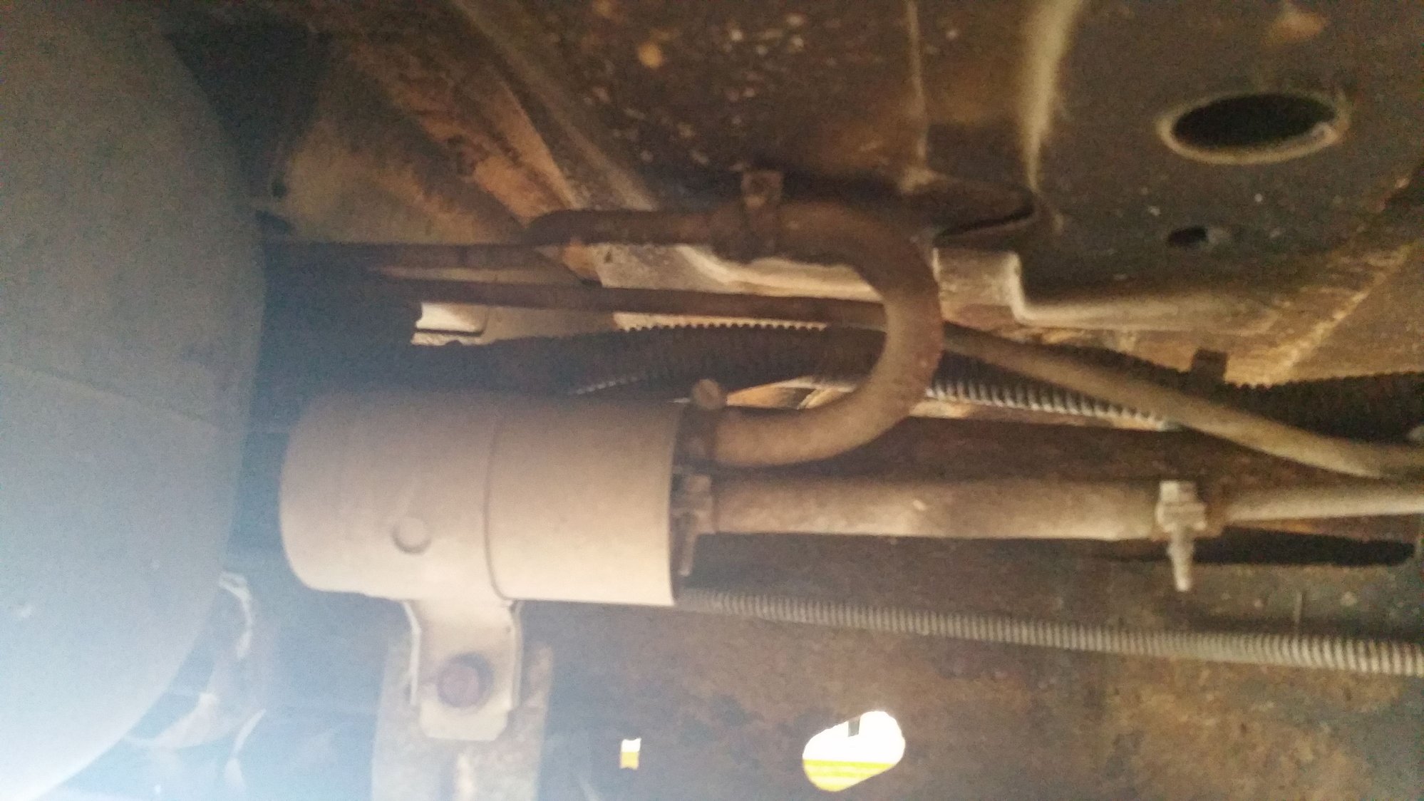

Toby Warford's Avatar
Toby Warford
Joined: Jul 2016
Posts: 704
Originally Posted by RalphP
Also not a rumor for the Gen1's.
Well, 1987-1995 anyway; 1996 doesn't seem to have an inline filter.
RwP
Actually, I know how many times I've said it, but once upon a time in recent months I was under my truck, to my shock there was an inline filter. However, I don't know if it's factory. As everything I've ever read or seen never had one.
Hmm.. should probably look into replacing it..
