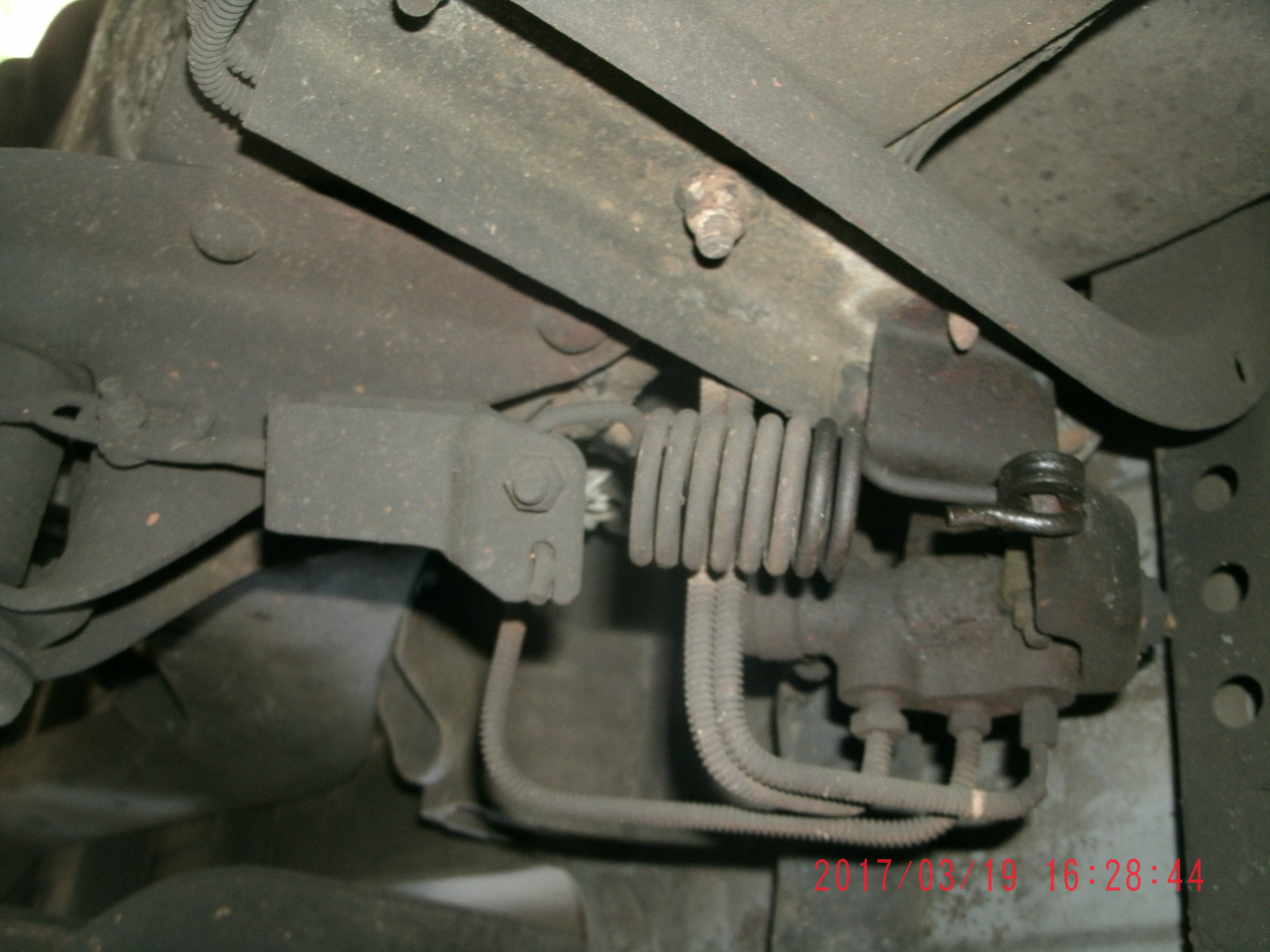

That should be close enough.
On my 1988, it's on the frame, but with a "hook" to the front of the driver's side rear leaf spring.
Your truck might not have one; if so, then it's a concern you don't have that I do *grins*
Here's a couple of pics of my valve, complete with the link to the front of the driver's side rear leaf.
