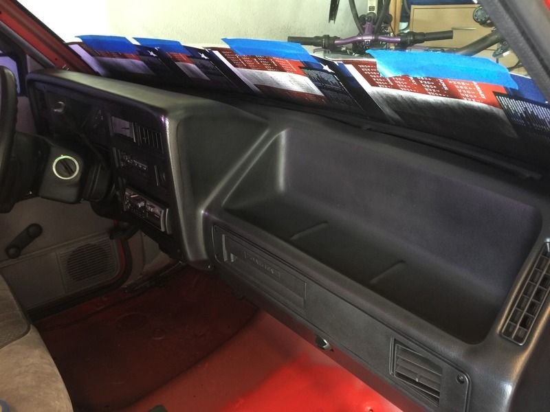

I did mine in place for what wasnt easily removed using a readily available Ford black. Please ignore the weak mask job, as I was having the windshield replaced soon after this was taken.
