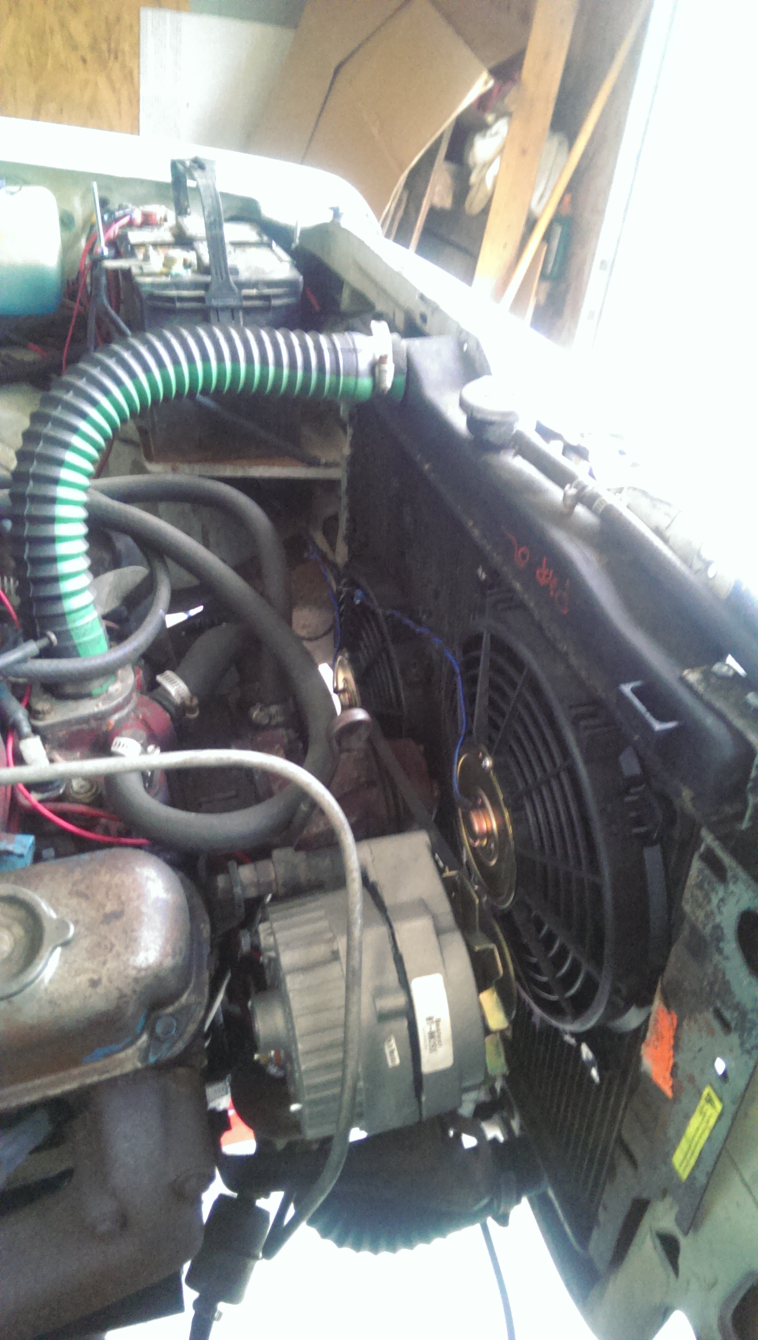

Would love to see a pic of your engine as it sits. Here's mine:
Realized I don't have any good bay pics. Have to take some when I get home.

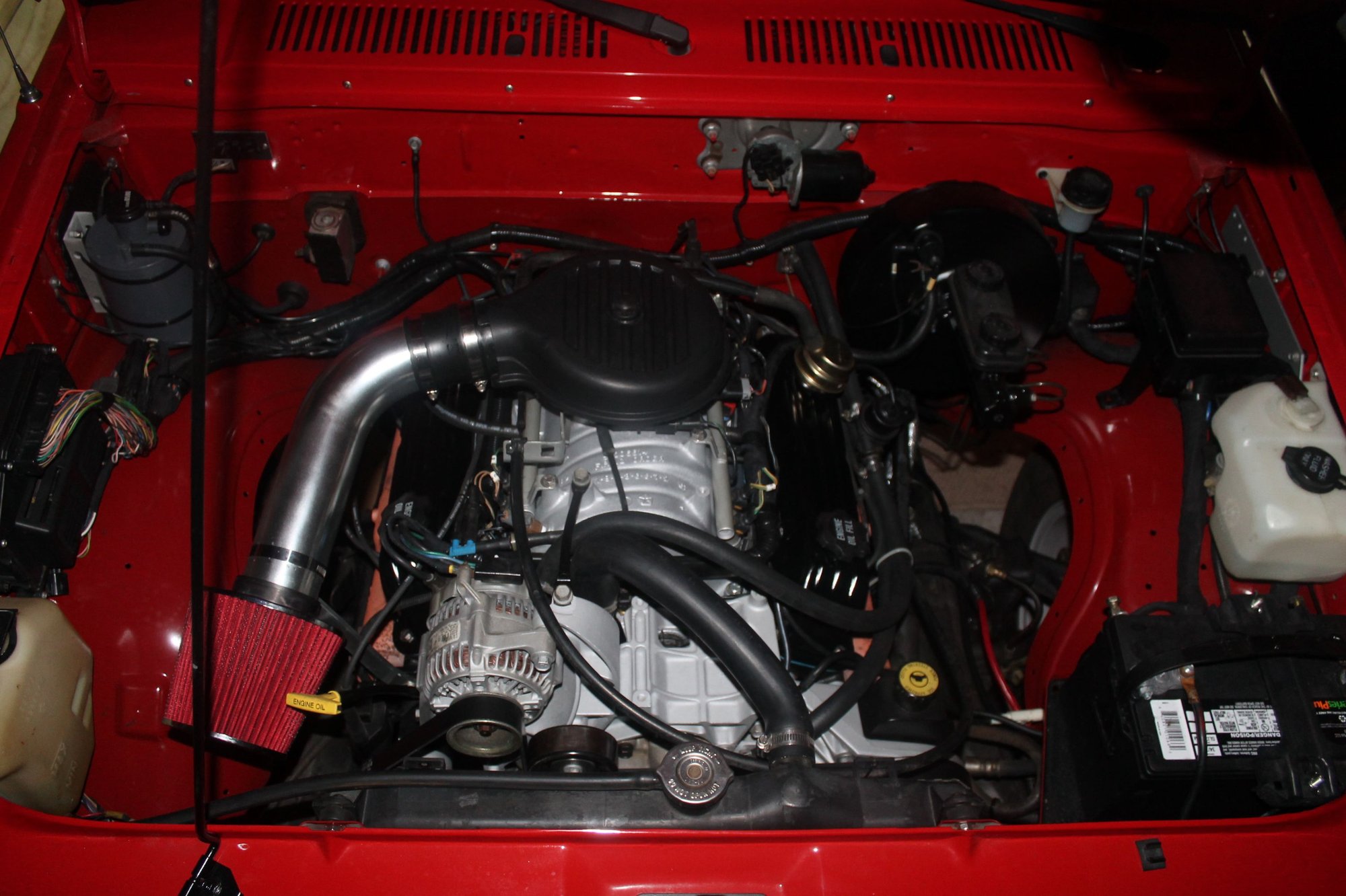

The hardware parts can be a little tricky, but there's still a lot of flexibility. To show you what I mean: I have a '92 5.2 Magnum in my '89 Dakota, a return-style fuel system using a '94 pump (fuel module modified with a return line), a '94 V6 automatic engine harness (with mods for my 5 speed trans and V8), a '97 5 speed, and a '92 5.2 HP ECU. The Magnum fits nicely on the '89 motor mounts, I just had to add e-fans in front of the radiator (I have a 4X4, but that doesn't make much difference beyond the trans). Robertmee's truck and mine were built within months of each other, he went with a crate 5.9 carb setup including v-belts and I used the 5.2 Magnum with factory EFI.
Mine:
