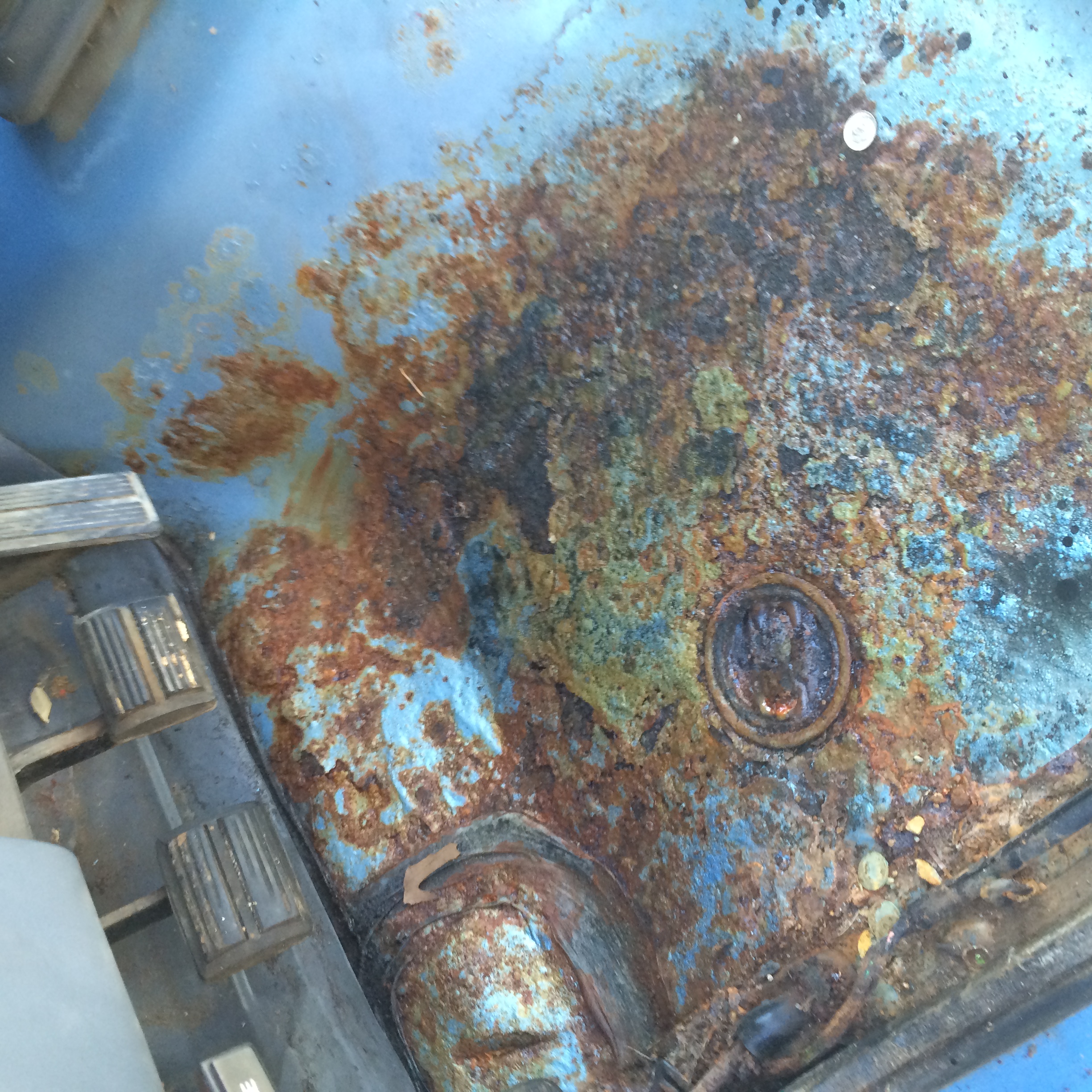

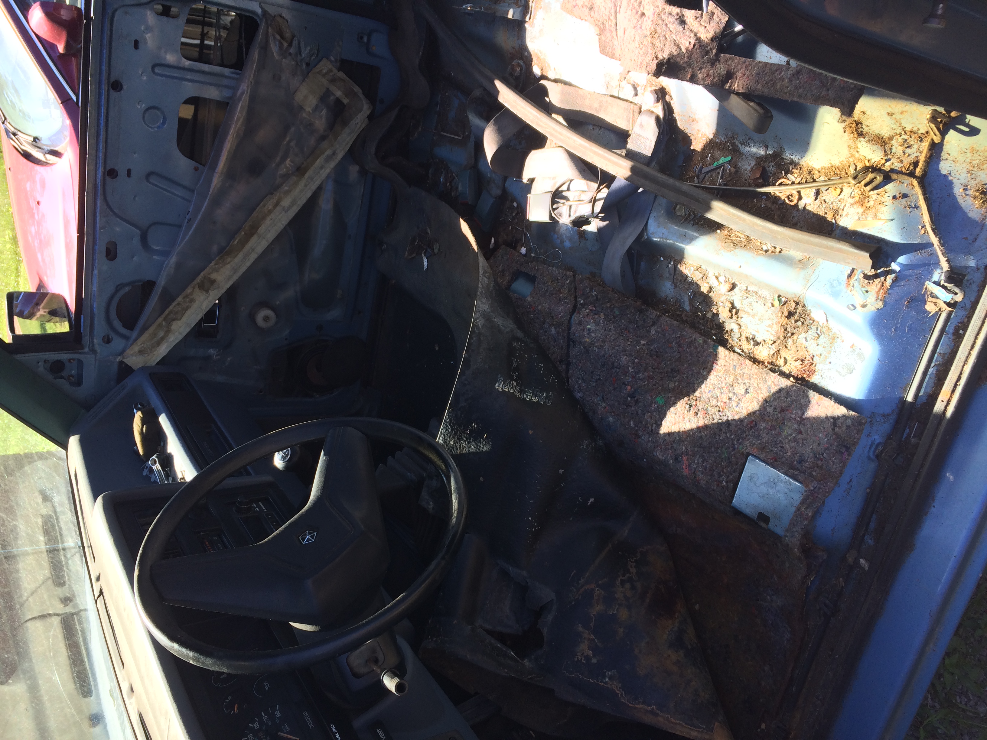

The backstory is that the Dakota got grounded a few years ago due to a brake problem and since then the issues have stacked up... a poor windshield seal ruined the interior, the shocks gave out, the brakes continued to rot and more. Rationally speaking I should have cut my losses and sent it to the junkyard, but it is a bit sentimental and I already have spent too much money to turn back now.

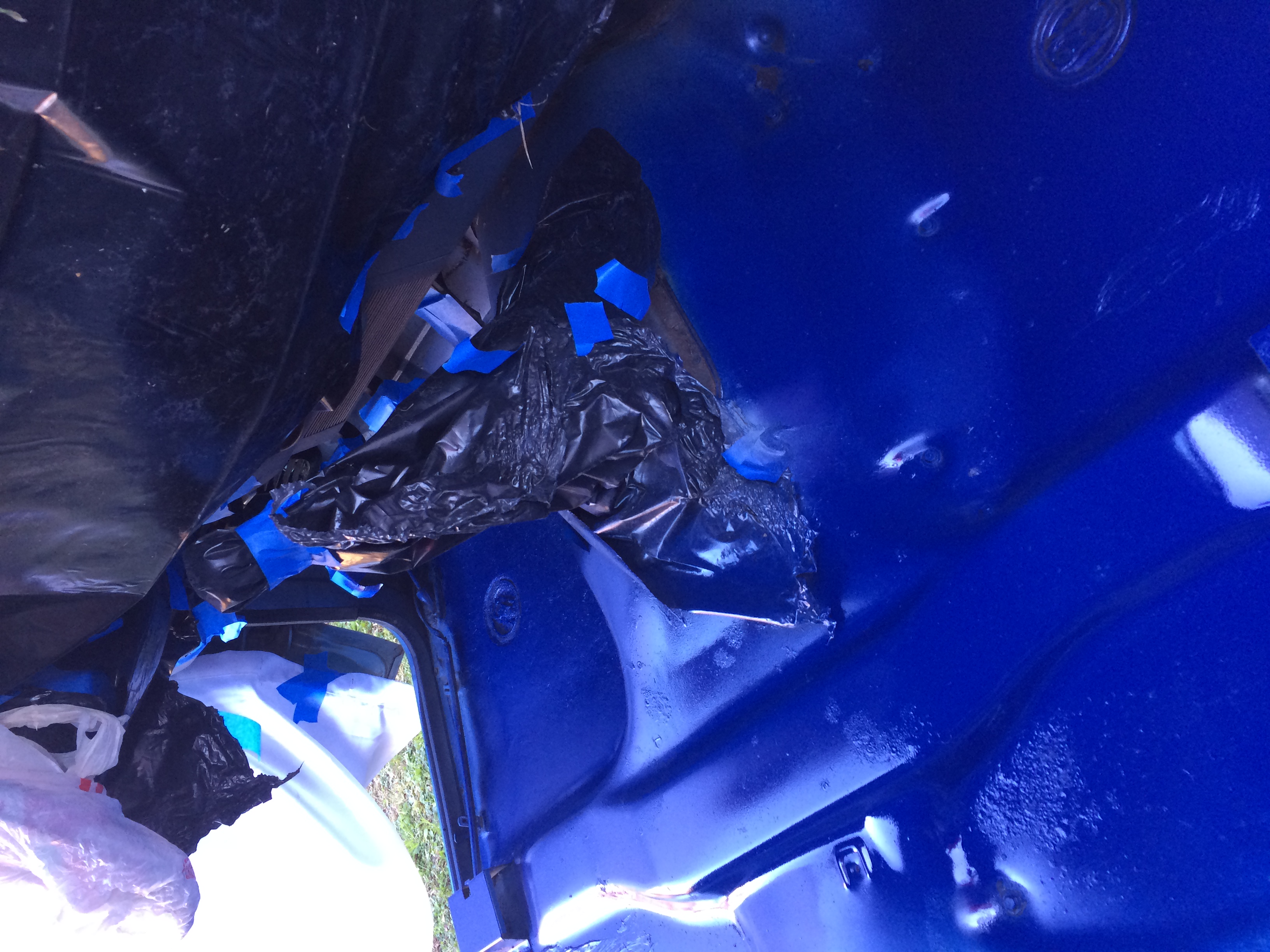

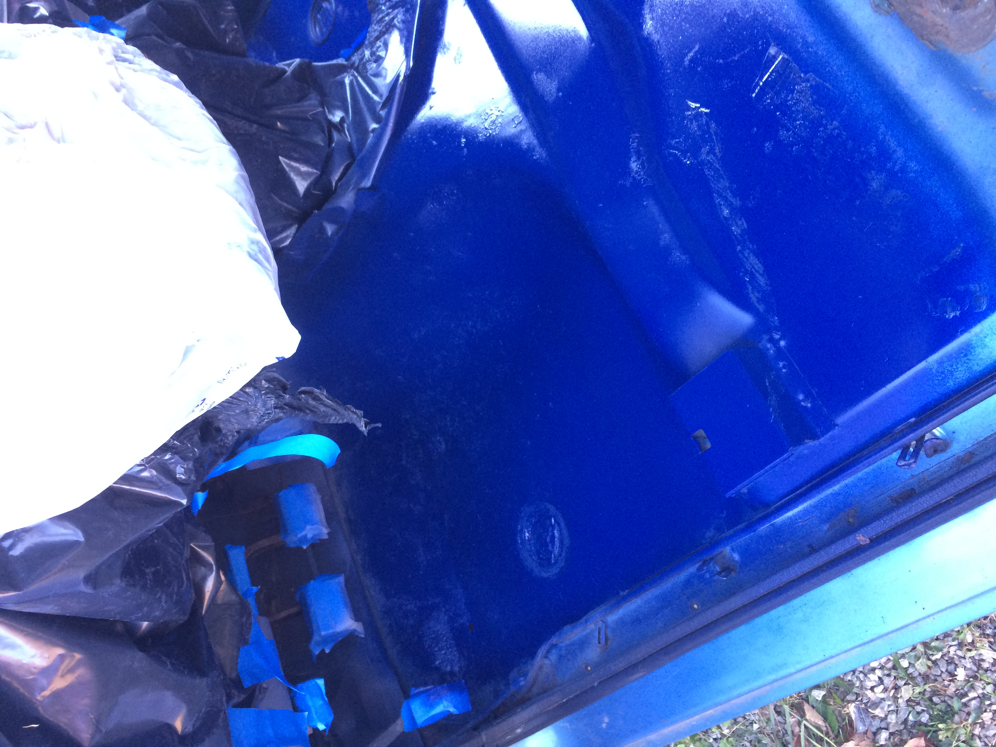

The first order of business was making the interior at least habitable. The vinyl floor was so wet and rotten from the leaking windshield that there was mold and even maggots growing in it. The plastic panels and dash had also started to rot due to the sun, water and mold. So, I completely ripped everything out of the interior. (See initial pics). Then I discovered that there was some rust on the driver's side floorpan. The proper fix would have been to weld a new panel in, but since there were no rust holes I just ground it down, applied some rust remover and then painted over it with rust stop compound. I'm having the seat reupholstered and I'll figure out some way to cover the dash.
On the mechanical side of things, first I replaced the shock absorbers which were totally shot with some new KYBs. Next I did some basic maintenance like oil change, filter changes, coolant flush and ps flush. I repainted the radiator fan and airbox with some engine enamel to cover up the rust on them.
